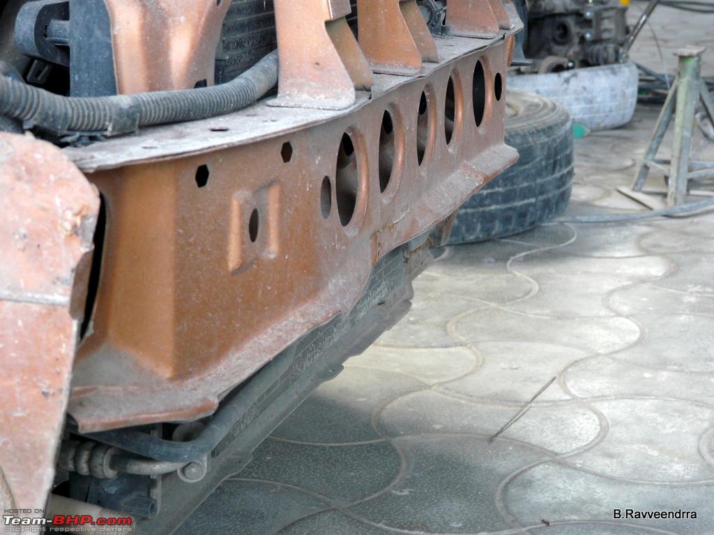

Above & below a nasty bend in the front cross member. This is going to be difficult to remove.
Fiat Palio GTX 1.6 acquired 2nd hand Edit: Pictures of Painting Process on Pg9-p1050896.jpg

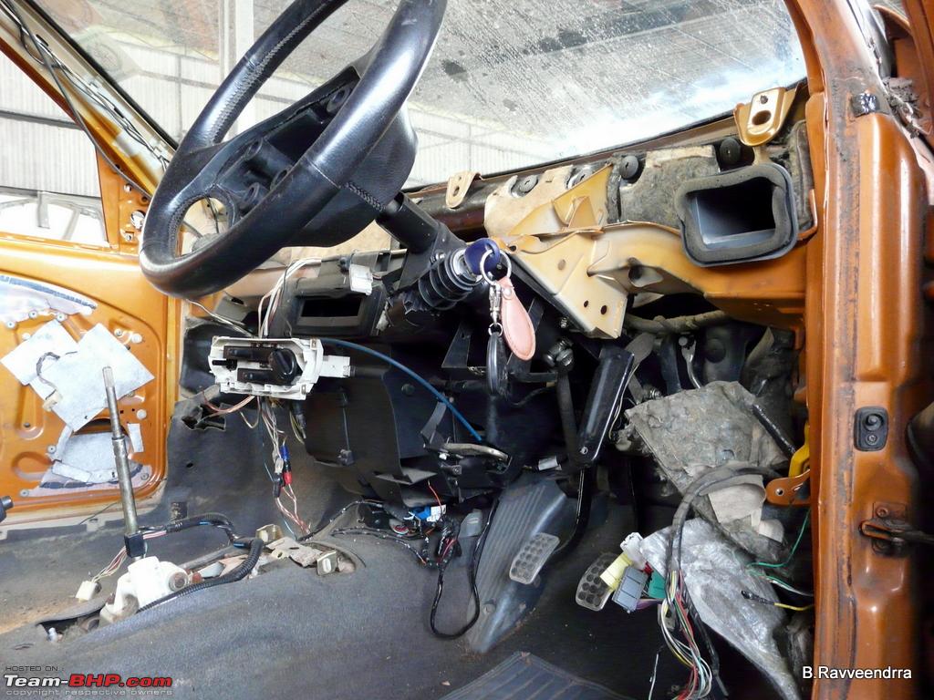

The inside after the seats and dash were removed
Fiat Palio GTX 1.6 acquired 2nd hand Edit: Pictures of Painting Process on Pg9-p1050900.jpg

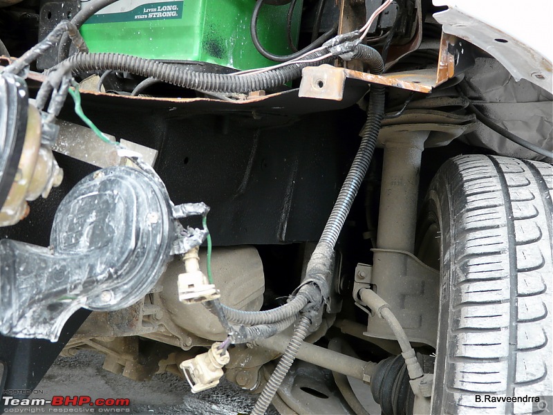

Under-bonnet showing the new anti-corrosion treatment. This coating also acts as a damper, sound deadener etc.
Fiat Palio GTX 1.6 acquired 2nd hand Edit: Pictures of Painting Process on Pg9-p1050978.jpg

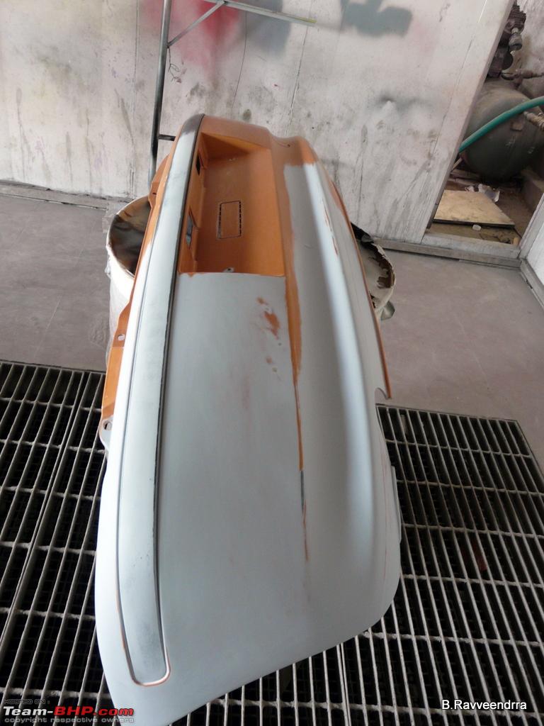

Some pics of the outside of the car after the filling.
Fiat Palio GTX 1.6 acquired 2nd hand Edit: Pictures of Painting Process on Pg9-p1050987.jpg
Fiat Palio GTX 1.6 acquired 2nd hand Edit: Pictures of Painting Process on Pg9-p1050988.jpg
Fiat Palio GTX 1.6 acquired 2nd hand Edit: Pictures of Painting Process on Pg9-p1050989.jpg
Fiat Palio GTX 1.6 acquired 2nd hand Edit: Pictures of Painting Process on Pg9-p1050990.jpg
Fiat Palio GTX 1.6 acquired 2nd hand Edit: Pictures of Painting Process on Pg9-p1050991.jpg
Fiat Palio GTX 1.6 acquired 2nd hand Edit: Pictures of Painting Process on Pg9-p1050994.jpg
All that black stuff came out of cans like this (about 7 of them).
Fiat Palio GTX 1.6 acquired 2nd hand Edit: Pictures of Painting Process on Pg9-p1050998.jpg
I decided against dismounting the engine so the engine bay esp. the aprons are now prepared to get a coat of paint.
The car would have got a coat of primer all over yesterday evening. Today they will start with a coat of solid glossy paint.

The anti-corrosion treatment is over. It was done before the primer was put on the car.
Originally Posted by bottle View Post
Great worklog, thanks a lot for posting all those pics! any chance of stuff going into the air intake in the wheelwell during spraying process ?
All pipes, intakes, electrical connectors etc. are taped shut / masked. Even if a little 'overspray' goes into the air intake pipe no harm will be done as it is before the filter and the filter will trap any stray paint particles.

A few pictures of the interiors in white:
Fiat Palio GTX 1.6 acquired 2nd hand Edit: Pictures of Painting Process on Pg9-p1060005.jpg
Fiat Palio GTX 1.6 acquired 2nd hand Edit: Pictures of Painting Process on Pg9-p1060006.jpg
Fiat Palio GTX 1.6 acquired 2nd hand Edit: Pictures of Painting Process on Pg9-p1060007.jpg
Fiat Palio GTX 1.6 acquired 2nd hand Edit: Pictures of Painting Process on Pg9-p1060008.jpg
Once the body is well under way, the bumpers get some attention:
Fiat Palio GTX 1.6 acquired 2nd hand Edit: Pictures of Painting Process on Pg9-p1060009.jpg
Fiat Palio GTX 1.6 acquired 2nd hand Edit: Pictures of Painting Process on Pg9-p1060010.jpg
Fiat Palio GTX 1.6 acquired 2nd hand Edit: Pictures of Painting Process on Pg9-p1060011.jpg
Fiat Palio GTX 1.6 acquired 2nd hand Edit: Pictures of Painting Process on Pg9-p1060012.jpg
