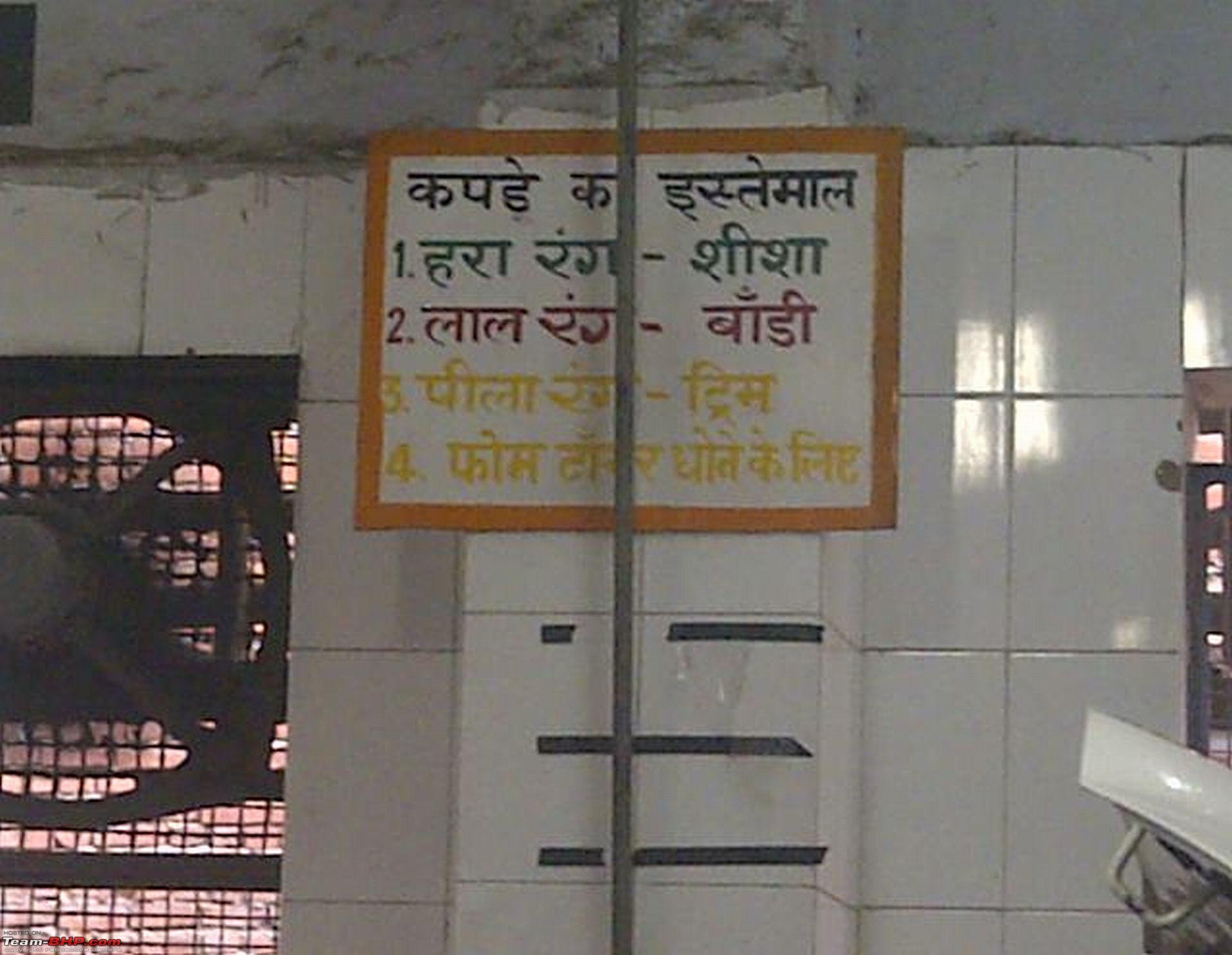

A Work Instruction Board for the workers to help them select the correct type of cloth for each different part of a car.
Obelix, the Invincible Toyota Fortuner! 2,00,000 km and going strong! EDIT: Sold!-img2012071300821washing-diffrent-cloths.jpg

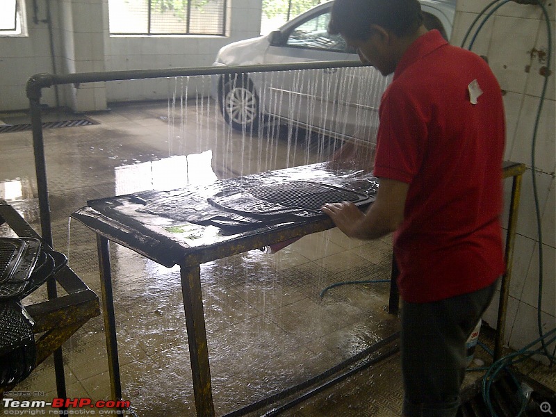

All mats were removed and taken for washing and drying
Obelix, the Invincible Toyota Fortuner! 2,00,000 km and going strong! EDIT: Sold!-img2012071300809-mats-washed.jpg
