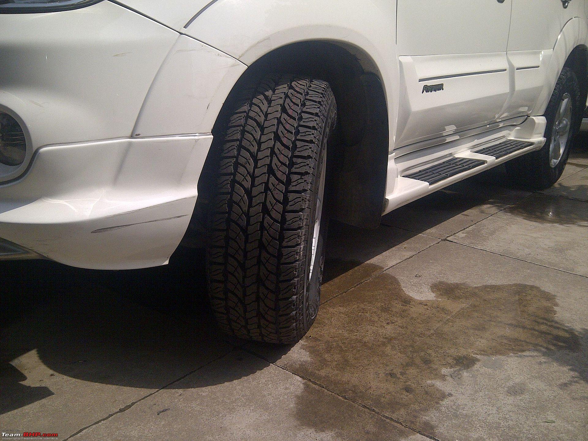

The Tyres after balancing and alignment was done at 72,192 kms
Obelix, the Invincible Toyota Fortuner! 2,00,000 km and going strong! EDIT: Sold!-after-balancing-etc.jpg
The New gleaming set of tyres enhance the look of the Fortuner.
Obelix, the Invincible Toyota Fortuner! 2,00,000 km and going strong! EDIT: Sold!-tyre-morning.jpg

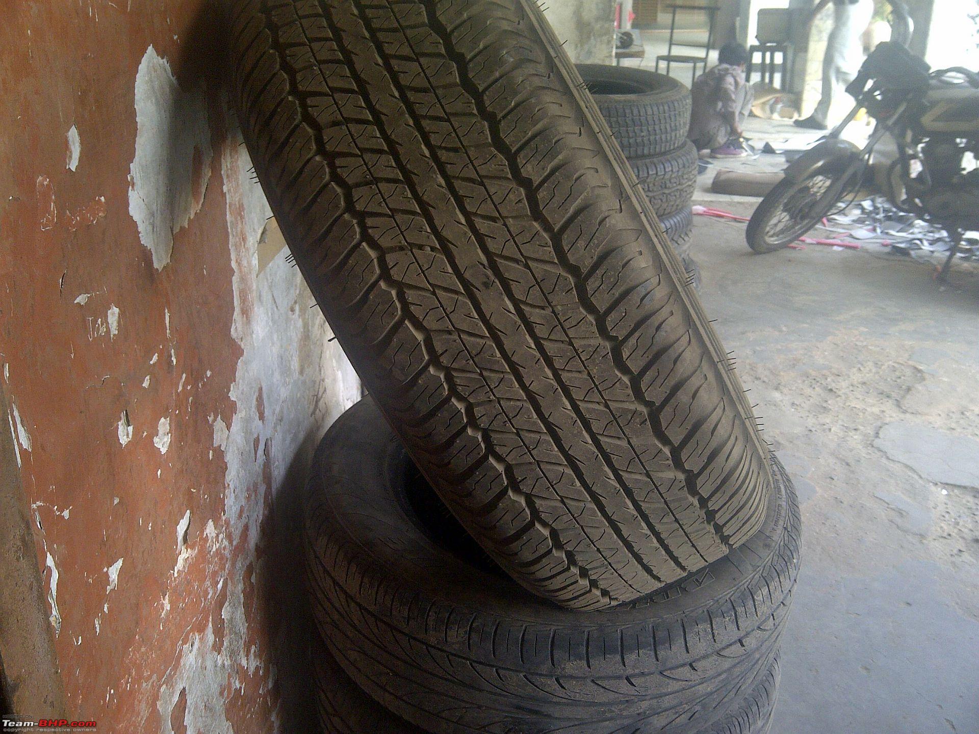

My brand New Yokohama tyre burst unexpectedly on a flat smooth highway at about 80-90 kmph. Luckily it was a rear tyre and the car did not lose control.
The tyre was just 20 days old and suffered catastrophic failure due to sidewall bursting within 1400 kms of use.
Obelix, the Invincible Toyota Fortuner! 2,00,000 km and going strong! EDIT: Sold!-img2012111001351.jpg
Obelix, the Invincible Toyota Fortuner! 2,00,000 km and going strong! EDIT: Sold!-img2012111001350.jpg
Never seen this in my life. As mentioned earlier the OE Dunlops lasted 72,000 kms and 3 years with no incident.
I strongly suggest that people use the same OE Made in Japan Dunlops when it comes time to replace their tyres.
If any one of the front two tyres had burst in such a way at that speed, i may not have been here to write this post.
Oh My God!!!
Thank your stars that nothing happened to you.
How can this happen to a new tyre. After reading good reviews about the Yokos, I had decided to change the shoes of my Endeavour to Yokos. But, this incident has shaken my confidence on the Yokos.
Did you take it up with the dealer and Yoko? Please keep us updated.

I was lucky that both the car and i escaped any injury and it happened when i was in the middle lane of a wide highway cruising at 85-90 kmph. If i had been overtaking or on a narrow carriageway things may have been very different.
I immediately called up the dealer "Grewal Tyres-Khan Market" and told him what had happened and he asked me to get the tyre over to his shop the next day.I went over as agreed on Friday 9th November at 12 noon.
After glancing at the tyre he told me "this is accidental..some sharp object has hit it and is not covered under warranty."
I asked him to get someone from Yokohama and he said he will do so. I left my tyre with him.
When i called him again at 5 pm no one from Yokohama had turned up to inspect the tyre. I waited at his shop from 5:30 pm till 6:30. At this time an "Engineer" from Yokohama Tyres India turned up and inspected the tyre.
He then repeated word for word what the dealer had said. They had already decided beforehand what was to be said.
I asked him what use was the warranty if they were never going to honor it. He said its only for manufacturing defects and does not cover cuts due to external "sharp objects" hitting the tyre.
I asked him if he had personally ever passed a claim or just to tell me the number of tyres that Yokohama had replaced free of cost ever since he has worked for the company?
He had no answer.
That the product is defective i have no doubt of.
That the company that manufactured it is NOT going to own responsibility and replace the tyre free of cost, i have no doubt of either.
This is actually strange Manuuj, and it looks like the tire went over something really hard and was embedded on the road, something like an angular metallic object.
Did this happen when travelling over a cement or an asphalt highway? Were you on a flyover or a bridge by any chance?
I am no expert on tyres, but from the picture, it seems to be a catastrophic failure of the tyre. The whole tyre seems to have torn off like a piece of paper. There might have been a sharp object, but a puncture is acceptable, but not this.
I would suggest you to write to Yoko directly with the pictures that you have taken.
The Delhi market is filled with very good 'duplicate' copies from China. Although your tyres look quite genuine from the photos, there would be no harm to get them cross checked by some higher authorities at Yokohama. Also, did the engineer carry some identification? His behavior looks suspicious. Such a early life tyre damage is even done under goodwill by good tyre companies. I know because 2 of my close friends work in them. Visit the regional/local Yokohama office. Kindly try to escalate the issue and don't give in lightly.
