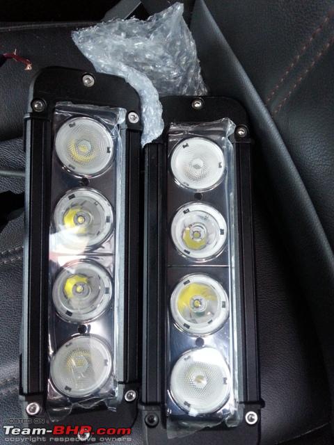

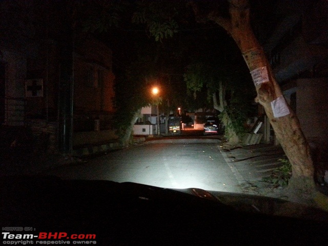

The pictures in this thread are taken from phone (first shot) hence apologies for poor quality; later this week will update more pictures with better resolution and compete wiring details.
10*4 = 40W X 2 LED Bar,
LUM 3440Lum X 2

LED is extreme bright on road and distract other drivers hence suggest use only when it required..

Looks good. Where did you buy it from and what was the cost?

Total cost of this setups is around 12k, i bought these LED from DX.

A quick note; while purchase LED look for IP rating.
http://www.ledwaves.com/IP-Ratings.html
PS:-the one i have in above picture is IP 67 FYR.

Actually most light bars are IP67
Dakar cars use IP68 which uses special glass which can withstand impact from rocks and gravel too at high speed. But this is significantly more expensive.
For example.
IP67 60W light in good quality can be sourced for 11000/pair
60W LED bar can be sourced for 12000-12500/pair
However, 60W Spot light pair is around 16000/pair minimum for IP68
Light bar goes to 20,000/pair or even higher in some cases for IP 68
Your idea of getting two light bars is good, but I would advise to go for spot bars only. In flood bars they just add a diffuser. So you don't get much diffuse pattern. Spot bars have a 30 degree divergence which is good enough if you are using two light bars, one under each light.

Infect single spot bar 60/80W was original idea but later i change my mind and decided to go with 2 combo LED bar for local resilience.

your bar is 10W cree LED each, which is a very good thing. Many people go for 60W or 48W light bars which have 16/20 LEDs of 3W each. The 3W LEDs are totally useless and throw light just right in the front, without any range. Due to large number of LEDs, they cannot use the big lens, and hence light is all scatter, and not directed.
Next step up is the 12W cree LED. Its the same LED, but with heavier heatsink which allows it to be driven at 12W instead of 10W.
So very good for range.
The light is also a bit warmer.
I foresee that in the next year or so, good sellers will graduate to 12W LEDs. Its awesome!
