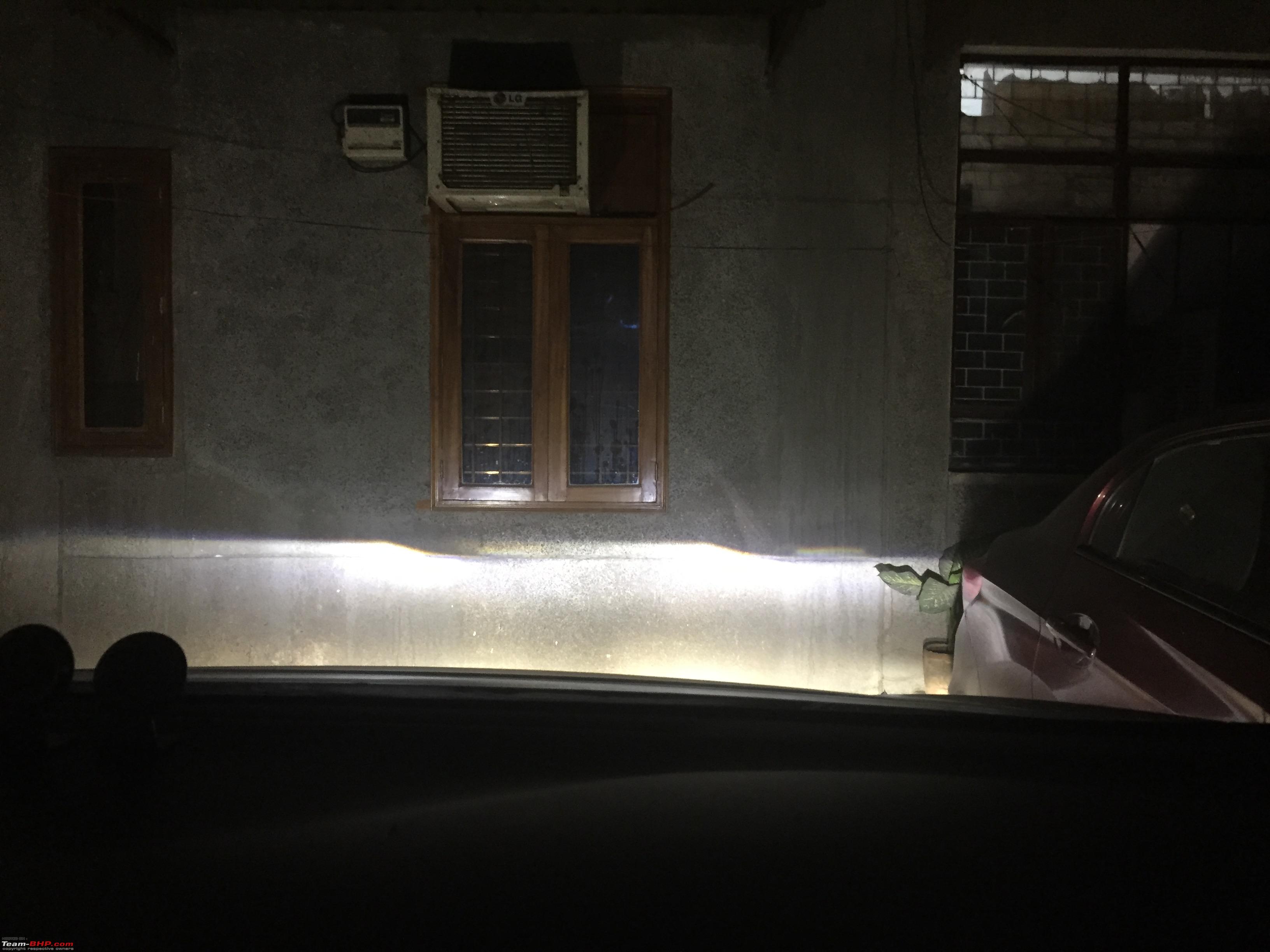

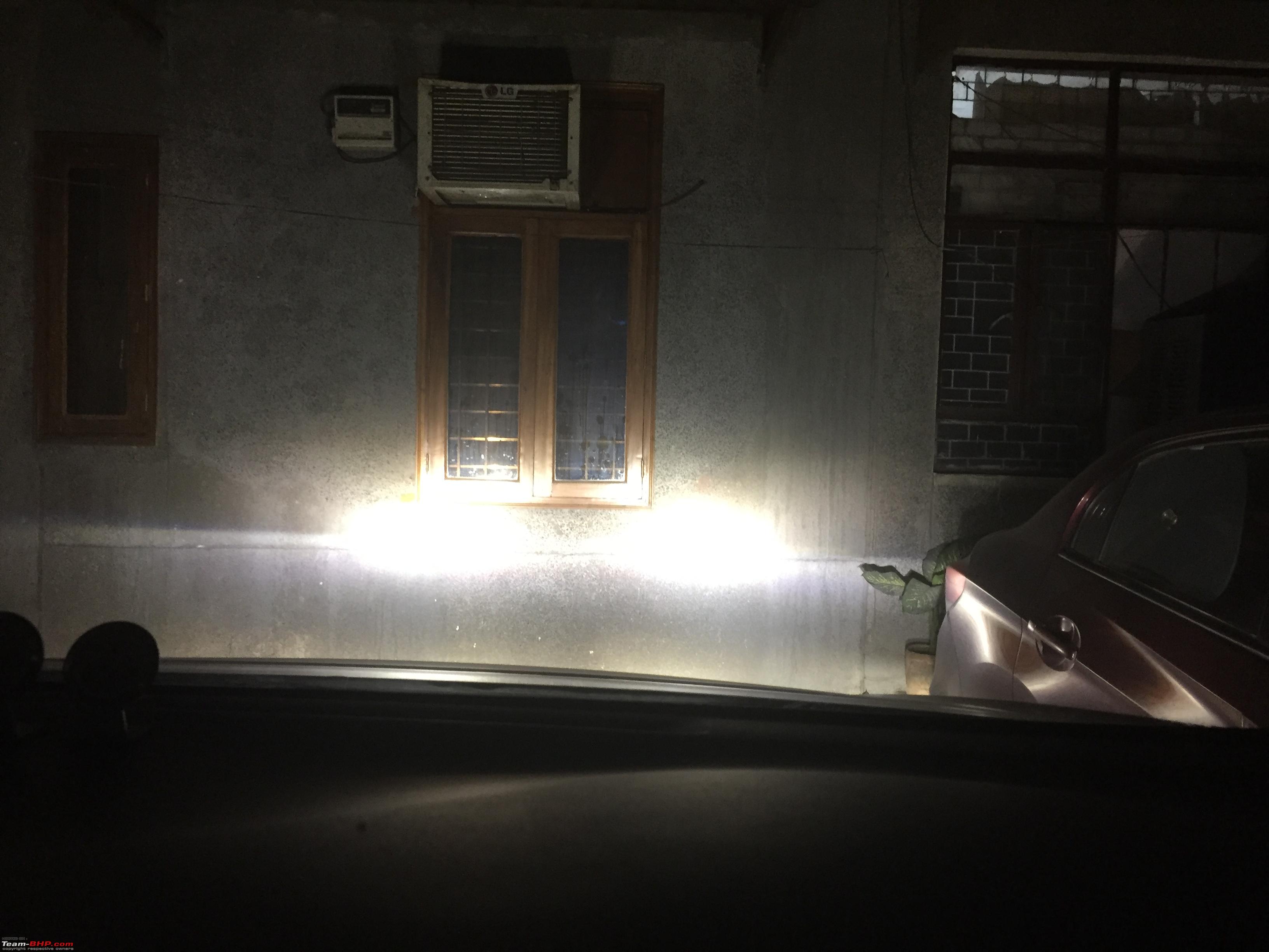

Originally Posted by AShubrah View Post
Can you please post pictures of the light output at night?
Also, how bad is the glare from the HID kit in the high beam reflectors?
P.S - You could get OEM Koito LED fog lamps like I did for my 2.4Z. These are the same ones offered in the Touring Sport & the Fortuner, have a wide beam pattern, and match the LED low beam’s colour temperature perfectly.
Yeah I read your thread and I agree it looks wicked. But I don’t like bright White light. Moreover, I wish to go with bi xenon projectors. I am attaching pics of hi+low and low beam against the wall. There is not much scatter or glare. Lower K HIDs gives better visibility than bright White ones.
On a different note, I have got the headlight levelling done from TASS, and raised it a little. The reason is that I keep high beam strictly for highway travels. And low beam used to go down way lower than optimal, with 5-7 people on board.
I’m leaning towards LED, because the gas discharge bulbs take a while to get to their full intensity, but I’m scared that the light won’t be focused or even as powerful as the OEM halogens.
What do you suggest?
I’ve gotten the same done a while ago, as the factory setting was a bit too low for safe night driving.
I would definitely suggest you to for LED. I went with HID only for warm white light.
Dipper becomes utterly useless in case of HIDs, But HID output = 5x LED ouput so try them both in each reflector and compare once before buying. There is a tremendous increase in output over OEM high beam. OEM halogens are utter crap in my opinion.
Moreover, LED output color will match your OEM led lamps.
You can always try it before getting it installed. It's a simple plug and play procedure which takes mere 15 mins. And i ll strongly suggest to go with morimotos, and wait if they are not in stock.
There is not much glare in my HIDs, but cannot say the same for higher color temperature ones without trying. And you dont need to worry about the scatter.
