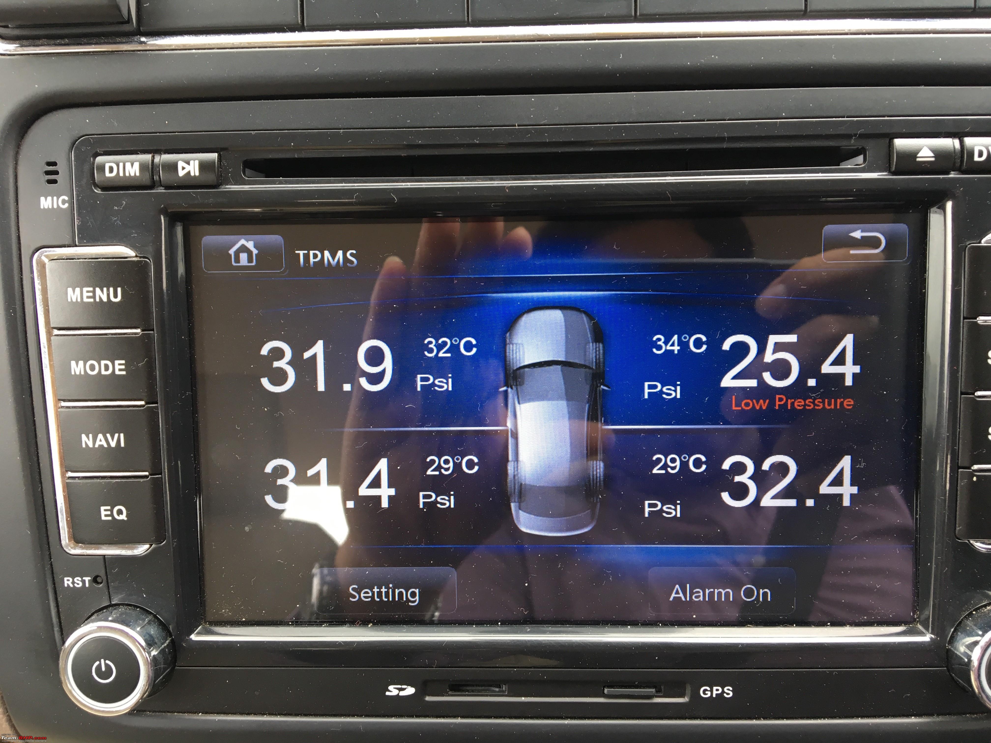

I have been using a TPMS, sourced from Aliexpress. It was a package deal along with the touch screen Head unit that I had bought for my Skoda Rapid (2015 Make). It was certainly a good buy and has helped me on more than a couple of occasions. For instance, the Air filling machine at many petrol pumps in my city isn't properly calibrated which has caused wrong inflation many a times. The TPMS helps avoid those situations. Highway rides are also more stress free as I can see the real time change in Temperature and pressure of the Tyres.
However Off late I have been facing a strange issue. The Tyre pressure in the Front Right Tyre drops drastically on Highway runs at speeds of 110 - 120. I usually don't exceed 90 - 100KMPH and most of the times my cruise control is set at 90. However on the occasional need for speed bursts I do touch 110 - 120 for a few seconds. It's then that the pressure of the Front right Tyre drops significantly. There is absolutely no drop in pressure while driving in the city or even while parked overnight. I have got the Tyre checked at two different shops and found no puncture. The second time, the mechanic recommended to fill Nitrogen instead of Normal air and probably the pressure won't drop as N2 doesn't expand or contract with temperature as normal air does and also explained a host of other advantages of filling N2 - In all the years of owning and driving car's I have never found these claims to be worth considering. However for change I did try filling N2 but the effect after highway run was the same.
It's not that the TPMS is malfunctioning as when the pressure dropped on the last highway run, I got the pressure checked and topped it up to the recommended level and continued driving at 90 - 100KMPH and there was no further drop in pressure. I am attaching the picture indicating low pressure after a spirited Highway run. Can anybody guide as to what the cause might be. I am little concerned to take the car on highway trips now.

Hello
Can you be really sure about your TPMS functioning correctly ? From what i have noticed in your picture ; the temperatures seems pretty low for a car which has been through a spirited highway run !
Maybe you could get the sensor checked up or even swapped with another tyre to see if it is functioning correctly. Drastic drop in readings when the tyre pressure seems okay to you visually is a classic example of a malfunctioning component; in this case your TPMS sensor.
A very peculiar issue you have. If the pressure really drops then the TPMS sensor is doing its job as it should.
If the problem arose AFTER you installed TPMS then the most probable cause is the valve stem. If its threaded type then have it tightened or replace if necessary

Originally Posted by atlantis0965 View Post
Hello
I don't think there is any issue with the sensor. Fearing that Tyre pressure might drop I was maintaining speed of 90 - 95 only. With Petrol pump in sight i.e. within 1 km or so I pushed the accelerator pedal and to my dismay, the pressure did drop. Moreover it was rainy season and the roads were wet, hence the temperature readings as indicated in pic. Other wise I have seen the temperature going up 45 - 50 Deg C previously.
I have installed this for more than 6 months now. Only now I am facing this issue. The valve system is threaded type. I will dismantle the Tyres and do the tightening again. Let's see if this helps.
