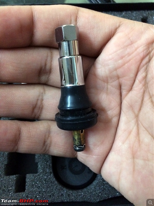

Packaging and Product:
SensAiry : An app-based TPMS-img_6452.jpg
SensAiry : An app-based TPMS-img_6453.jpg
SensAiry : An app-based TPMS-img_6455.jpg
SensAiry : An app-based TPMS-img_6457.jpg
SensAiry : An app-based TPMS-img_6458.jpg
SensAiry : An app-based TPMS-img_6460.jpg
SensAiry : An app-based TPMS-img_6461.jpg
Contents in the box:
  • 5 Sensors
  • 5 Stem Valves
  • 5 Mounting Valves
  • 1 User Guide
