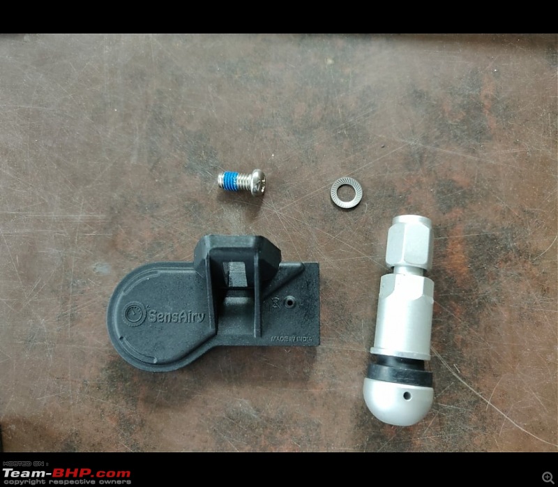

I've been using the internal ones for close to 4 and half years now. 1 sensor went dead about 6 months back. Others are working fine. I have the replacement sensors with me but apparently they are not configured to work with older HUDs. Moreover, not sure if the newer valves fit on Brezza alloys.
SensAiry : An app-based TPMS-screenshot_20210927105317__01.jpg
Old valve.
SensAiry : An app-based TPMS-screenshot_20210927105224__01.jpg
New one.

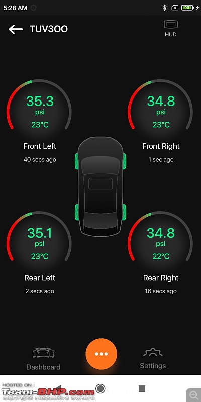

Thanks for the suggestions and all the details available on this thread, I got the internal TPMS fixed today at Bengaluru ( Sai Iyengar tyre centre or SLD tyre centre). Met Ajay, who was very co-operative throughout the process, got the app installed in phones plus apk installed for android-auto.
Here is how it's working so far,
SensAiry : An app-based TPMS-20210930_125251.jpg

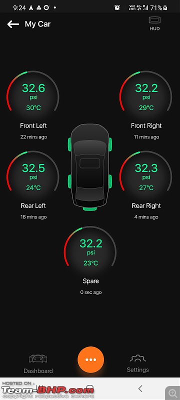

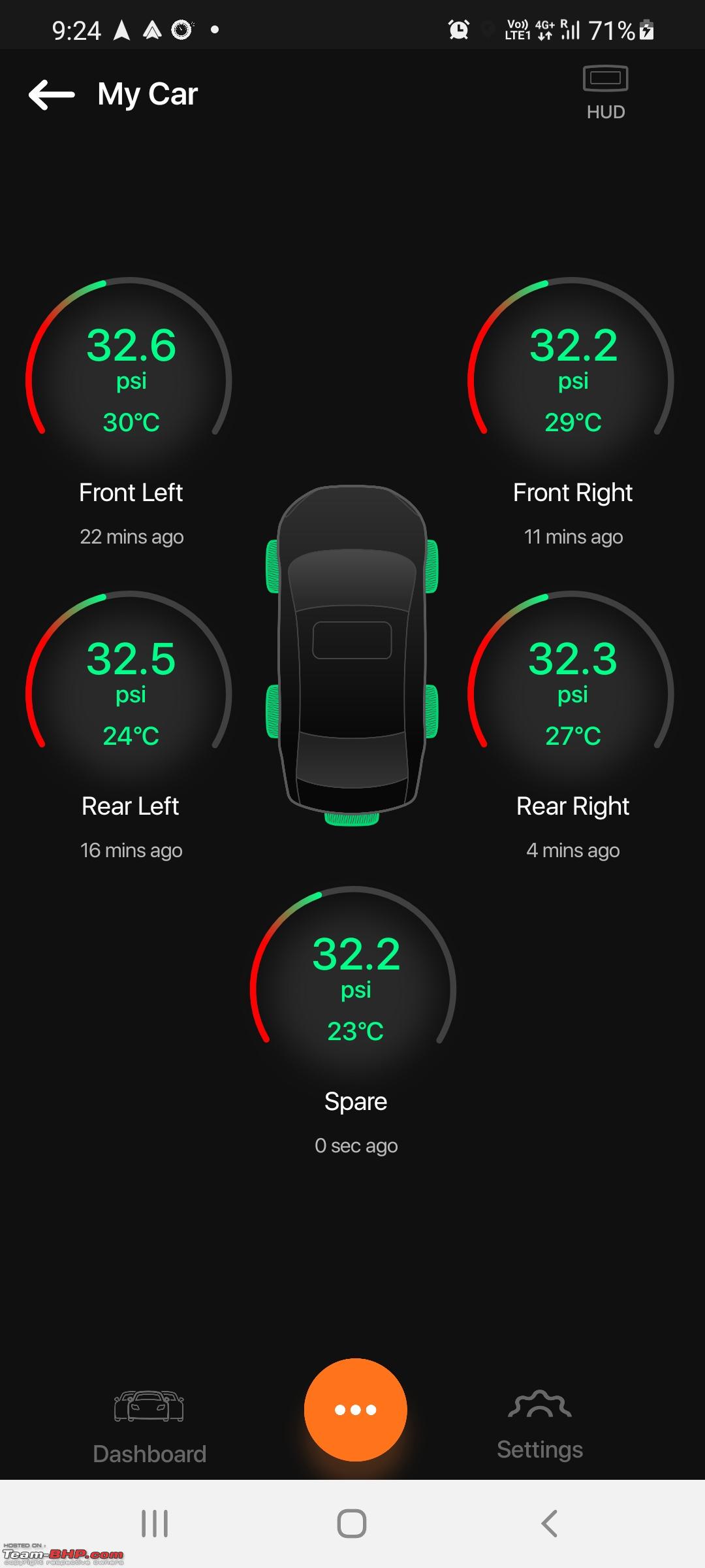

Well there have been some recent developments and I should have seen it coming. I am seeing significant delays in the app updates for the recent tyre pressures for all 5 tyres. And this is mostly happening when phone's bluetooth is shared with Car's multimedia system (Sync3 in my case). Attaching few images for reference,
SensAiry : An app-based TPMS-screenshot_20211002172006_sensairy.jpg
SensAiry : An app-based TPMS-screenshot_20211006092419_sensairy.jpg
SensAiry : An app-based TPMS-screenshot_20211007100017_sensairy.jpg
I'm in constant touch with Ajay from Sensairy and he has been very helpful so far, still trying to find a solution for this. Otherwise, I fear I'll have to live with it by dedicating a mobile just for monitoring the TPMS only
Also one more query, how often does everyone check their APP for the tyre pressure? Like everyday once, twice or weekly once, twice ?

I never check at all. I have kept the app with auto-start permissions + removed it from all battery optimizations. Effectively it remains always running, and I let it keep the icon badge permanently in the status bar (all this on Android of course).
I've set the thresholds for upper and lower pressures in all 5 tyres in both my cars in the app. I get audio alert when the threshold is breached in any tyre. Then I check. Otherwise I don't open the app at all. This IMO is the beauty of it.

Not sure if this is the best workflow but what I do i switch on the app when i get into the car. It successfully connects and updates the tyre pressure by the time the engine warms up.
After this point I don't bother with the app anymore. As far as I know the app is meant to give an alert for any pressure loss in the tyres (even for slow leaks). If I do check the app later on it would only be during fuel or food stops.
Didn't realize that having the mobile bluetooth occupied with another device would slow down the app. I guess then the only way out would be to use the usb cable to connect the mobile to the infotainment system.
Actually I've tried that, the problem is with the cellphone connected via USB cable on the Android Auto, the bluetooth is again turned on automatically. And this will again result in the same problem of slow updates. Now my only point of concern here is, because of the slow updates, I may never get the timely alert of air-pressure leakages at all

About 10 months back during a long drive when we stopped for a tea break, I noticed that pressure was not updated for nearly one hour from one of my tyres. I had to switch off/on Bluetooth on the phone couple of times to get reading from that sensor again. Now if we assume that TPMS App will alert in case of significant fluctuation of tyre pressure, it may not if it is not getting reading from sensor for a long time.
Then I thought Bluetooth sharing may be an issue. We had an old android phone at home, which is now dedicated for SensAiry TPMS. This phone is without any SIM card and I use Wi-Fi for App updates. I have not seen delay in tyre pressure update here.
