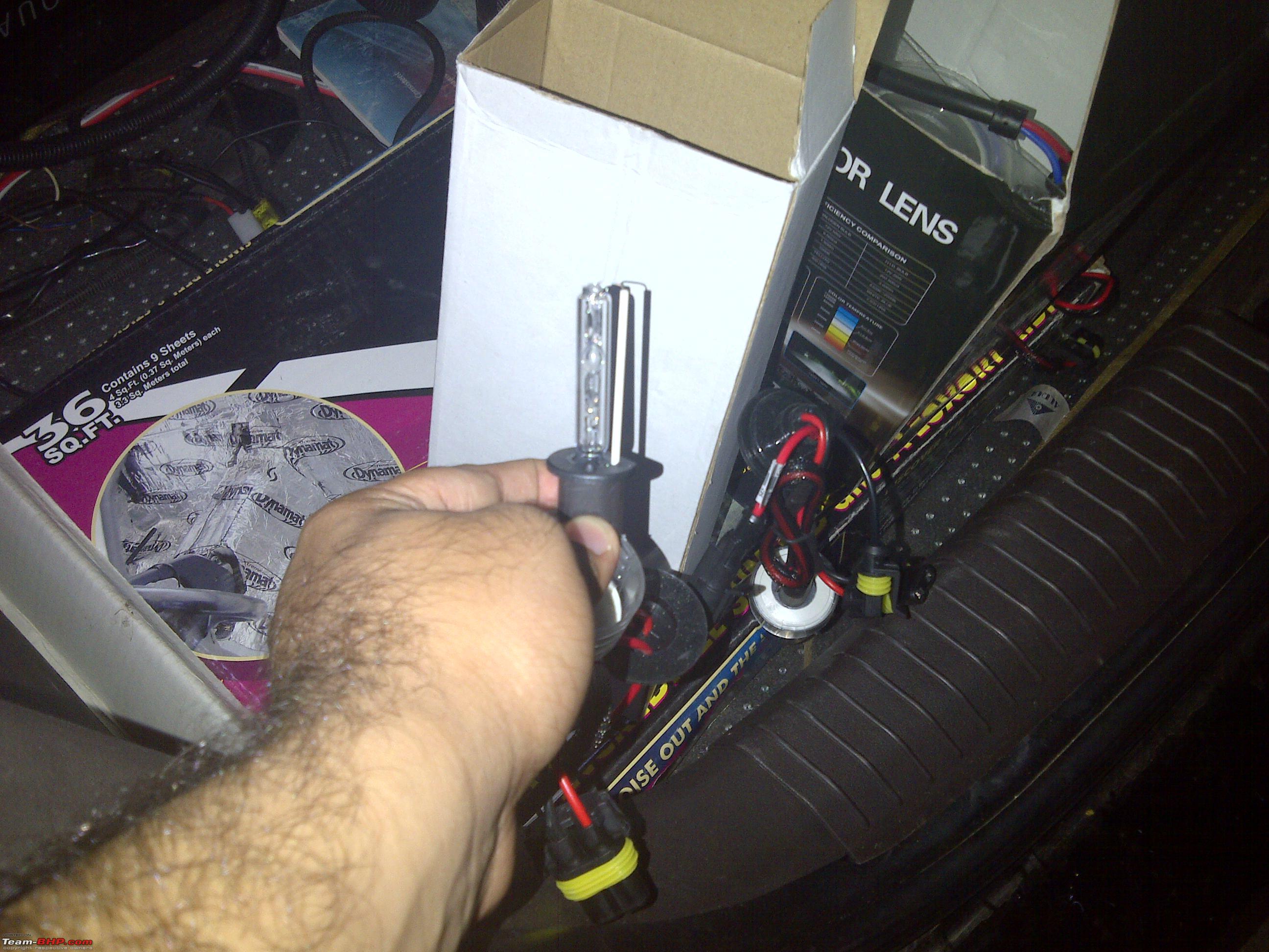

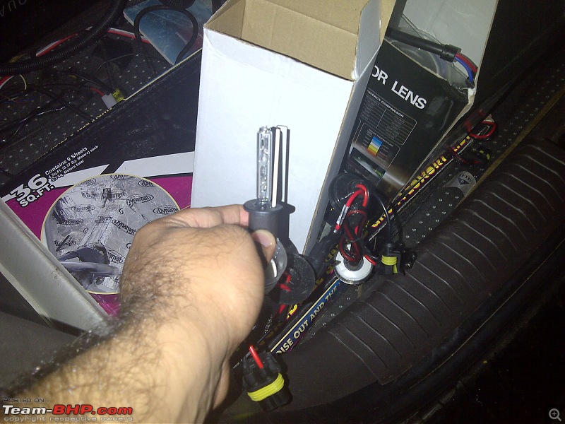

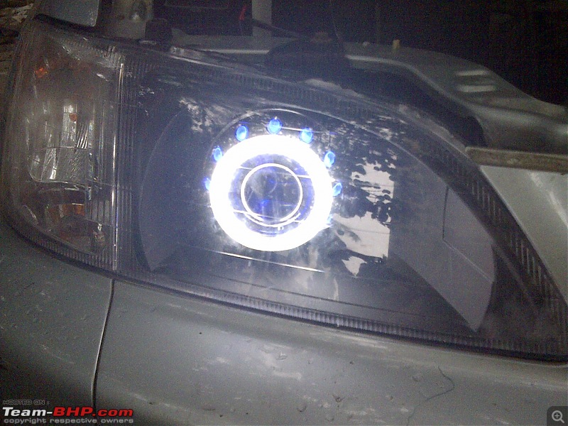

Some kits used by my friend. The red and white angel ring is done on a type 2 Honda CRV.
@Ryan_wheelz - Think you know this car.

Wow, those are some neat options. Whats the cost on them?
Also judging by the english on those images, the kit looks like china stuff. Does that mean that the HID bulbs too are not quite reliable? Or are these kits similar to the Philips / Osram HIDs or other kits? I'm not too familiar with the HID setups and I was looking to research a few for my own OHC.

FYI, the pics attached are not mine. These are from my friend's latest installation. I have a Swift with aftermarket projectors made in Singapore. I use Auto Gauge HID's. The ones in the OHC are not branded.
