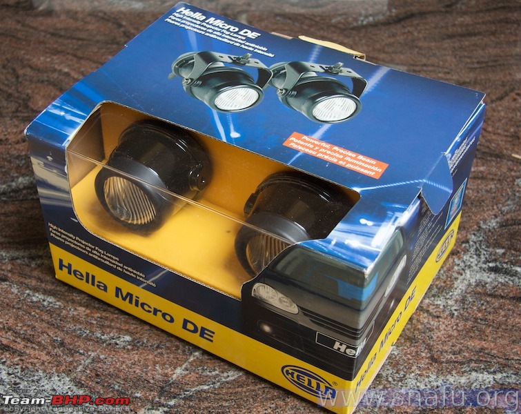

Originally Posted by wanderernomad View Post
dr am not looking to blind oncoming traffic at all. Merely interested in lighting upthe road better especially highways. Baleno lacks fogs and hence I thought of buying these projector types of an audi. Will they not improve the lighting any bit?
You can consider Hella Micro De Fogs which are projectors comes with a pair of H3 12v/55W halogen and wiring harness including relays on a price tag of 4.5K. This is also not vehicle specific model so it can be used on any cars without much modifications.
Fogs by design are for seeing the road about 10 meters up to the front and sides only. If you drive in foggy conditions then go for it but if not then you should get auxiliary driving lights mentioned in the previous link. For highway driving choose between Spots and Driving lights. Choose spots only if you travel above 120 kmph constantly. Those Hellas mentioned are available in Spots, Driving and Fog versions. Take your pick. I would always suggest High beam driving lights. What ever you buy make sure the bulbs are either H1, H7 or H3 as these are the only ones that are easily available in India. H4 is commonly available but not for your intended use.
Previous link means the post by sajjt above for the hellas, right?
I was talking of the link provided by me. The link posted by SAJJT of the MicroDE does not have a version other than fog lamp. You need the driving lamp version or the Euro beam version which will suit your purpose better. For highway driving at sedate speeds you need auxiliary driving or euro beam headlights. Go to the Hella USA site and have a look. Fogs as mentioned before are good for near field vision and will not help you in highway jaunts.
The 120mm Hella projectors are not easily available but it will be worth your while if you can get it from abroad. Try to get hold of a unit with lens of at least 10cm and above when buying projectors if you cannot get the 120mm Hella's. The cost for 2 pieces works out to about Rs 8500/-.
IF you cannot get hold of the 120mm projectors then the least that will serve your purpose is mentioned below.
Susquehanna MotorSports - Auto Performance Product
Nice update Dr, surely 120mm will offer better low beam spread, but taking into consideration that these are dedicated beam projectors, this can't be easily mounted to a normal car as the size of the projector is too massive, 124mm width (4.78") and 200mm(8.5") length! Nowadays new gen cars have very little space for extension behind the HL assy. May be its more suitable for a SUV HL assy than a car HL assy. Else, have to think of bixen projectors but are we satisfied with a bixenon projector's high beam? Being with a Bixen projector for more than 1 year am still jealous about the dedicated high beam reflectors as it can offer better beam spread than a bi xen can do. It cant be compared just because of its pencil beam abilities. Bi Xen projectors are too good for low beam but when it comes to high beam, its a disappointment as we all are pampered with reflector based headlights
Now after seeing your link for 90mm high beam module from Hella , my mouth is watering, it could be a killer setup and price wise also justifiable once it can be a hand carry luggage from US. But for me its a big no as its not feasible in my present car
BTW, Hella Micro De is designed for low beam as well as Fog purposes as per Hella site:
DE auxiliary lamps, a Hella innovation, are ideal for low-beam and fog lamp use. DE technology uses an elliptical reflector to directs the light source to a focusing lens which bundles it and projects it onto the road. A shield positioned between the reflector and the lens provides precise cutoff.
Lamps are offered in halogen and Xenon versions, and their small size makes them perfect for most vehicles.
