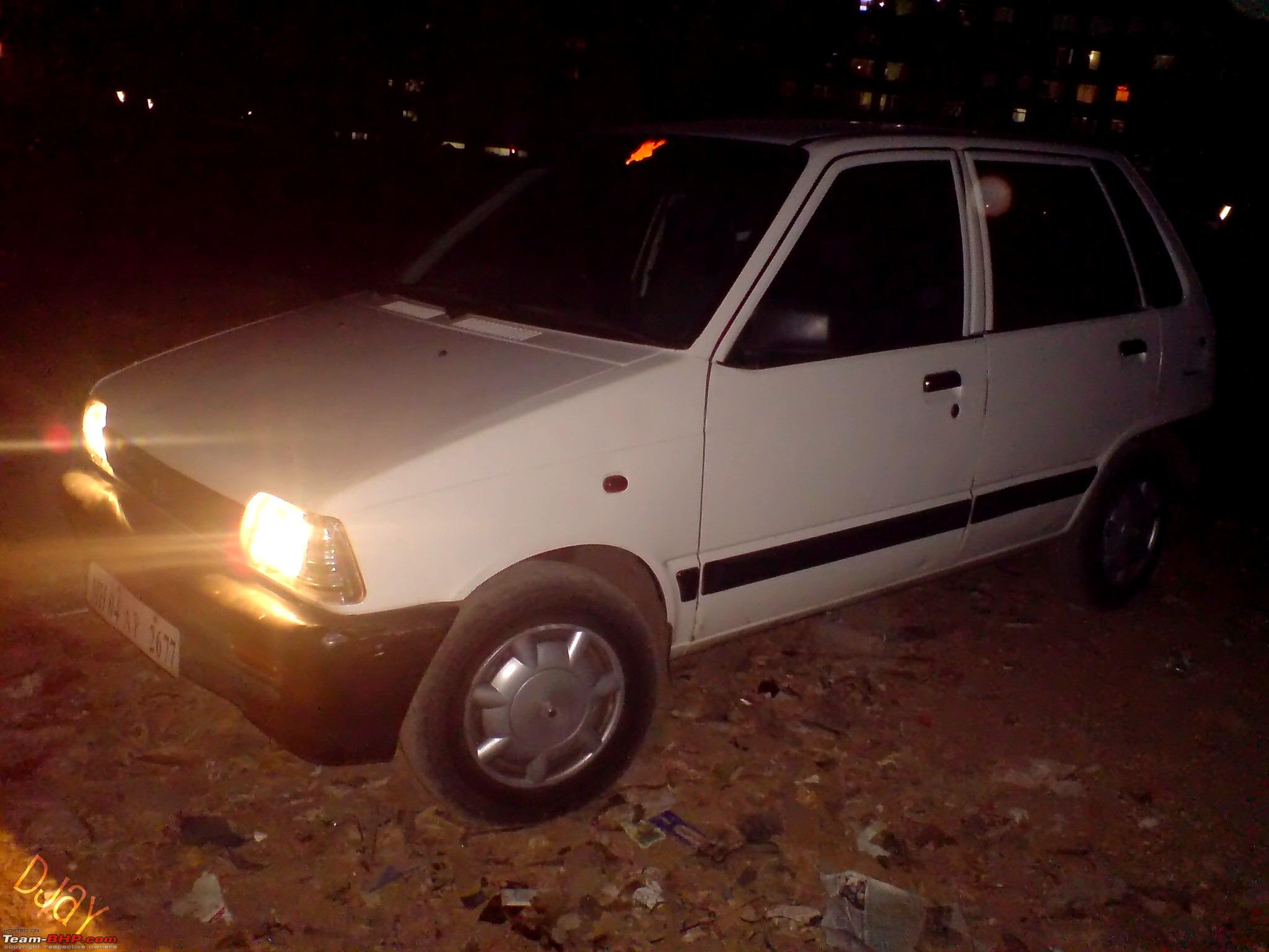

Hello guys i have also fitted maruti 800 (type 3) headlights in my m800 (type 2) with osram 90/100 halogen lamps with solar company relay with 1 year warranty
this is just the pic of dipper on and not upper on
Auto Lighting thread : Post all queries about automobile lighting here-dsc01227_filtered.jpg
