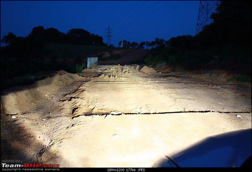

You could try Philips Night breaker or Osram cool blue. Although these produce White light, the output wont be as expected. They advertise 80% more light than normal halogens which aint true. You may experience slight improvement over standard halogens. Since you already have projectors in your Laura, you could try HID's. 6000k color temp producing White light.
But for this you need to install ballast.
Please see the pics below. This is the output of my Swift running on Projectors with 4300k HID's. Pure white with a tinge of Yellow. This color temp offers the best visibility range.
Auto Lighting thread : Post all queries about automobile lighting here-low-.jpg
Auto Lighting thread : Post all queries about automobile lighting here-high-.jpg
Auto Lighting thread : Post all queries about automobile lighting here-low.jpg
Auto Lighting thread : Post all queries about automobile lighting here-high.jpg
