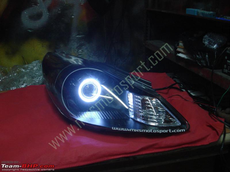

Yes the i10 has issues with space when putting in HID kits ..... In fact, there is one more issue which I came across..... its about the fact that most other cars come with double wiring and i10 comes with single wiring which makes it technically difficult..... I donno how to xplain in detail ... I am sorry.
Although that said and done, I do have a swift running H4 Bi Xenons + H11 Xenons both burning @ 10000K on 55W ballasts ...... and they are housed in OEM headlamps with no projectors. I thought about installing projectors for the same, but realised that either the projectors available are for halogens and if the retrofit available is for swift's OEM, then there is a chance it may leave gaps in the fitting unless done perfectly. This may later lead to dust accumulation in the unit leading to more glare.
The other option is to change the unit all together. I thot abt it as well. The usual Angel eye kits with projectors available in the market are nothing less that useless. One of my friend's installed it and didnt run for a week that he decided to throw them away. So I did some digging and came to the conclusion that MARS sells excellent aftermarket Headlamps with projectors for Swift. It was an excellent unit, looked like it was built to last and had nice quality. But luck didnt favor me there as well for MARS kit of Suzuki Swift does not support H4 bulbs.
So the OEM bulb or H4 Bi Xenons does not fit in the MARS kit in case anyone is planning to buy it.
Finally I gave up and came to the conclusion that if you want to be a responsible driver, drive low beam when there is oncoming traffic and all will be well. Usually what I have noticed is that when people see me coming from far, regardless of the car they are in, they automatically dim their lights as I come closer. It sure does put a grin on my face. Very rarely has anyone tried to put high beams against me. I still dont put high beams, so all is well...... no cops have caught me so far(Touchwood).
@ Naveen.raju -> I went with 10000K knowing its blue because I wanted something different. I have LED washer jets on the hood which have blue LEDs facing the front. I also have Blue theme for interior of this car, so call me stupid but I went with it .....
Auto Lighting thread : Post all queries about automobile lighting here-2.jpg
Auto Lighting thread : Post all queries about automobile lighting here-3.jpg
Auto Lighting thread : Post all queries about automobile lighting here-projectorheadlighthyundai20i10.jpg

By the way, forgive my noob mistake guys, the pics I have uploaded in my previous post are
Left to Right
1. HID @ 6000K with projectors(55W)
2. Same without projectors
3. i10 headlamp unit with projector installed (courtesy mxsmotosport)
