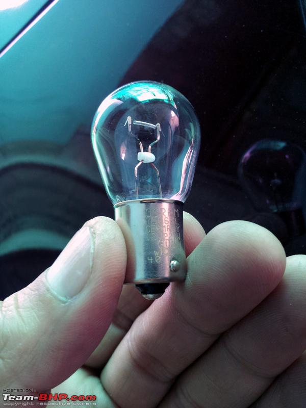

Any source of LED bulbs locally in India? I want this one and had a bad experience ordering from abroad. They got lost in mail. So a local procurement source (preferably online in India) is required. If anyone can guide me to it...
Its a 12V P21W bulb and I require the same in LED -
Auto Lighting thread : Post all queries about automobile lighting here-superb-drl-bulb-p21w.jpg
You just might, on eBay, but expect a 200-300% markup.
