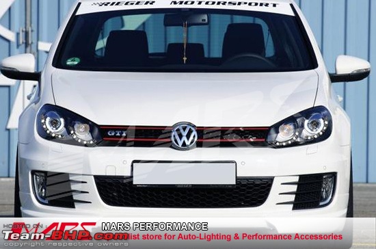

I saw the following projector headlamp kits for the golf on a australian website which seem to be a correct match for the current polo here in india. But they are quoting 799 AUD for it. Anybody anything similar and less expensive?
DAY-Time LED DRL & CCFL Angel Eyes Projector Head Lights for VolksWagon Golf VI 09-11
Currently there are no readymade kits for polo/vento available in India. The best option would be to get a bolt on projectors and fix it onto the existing headlight assembly. But wont have the finish of the ones you had attached.
As far as I know, these readymade projectors will cost around 20k min.
