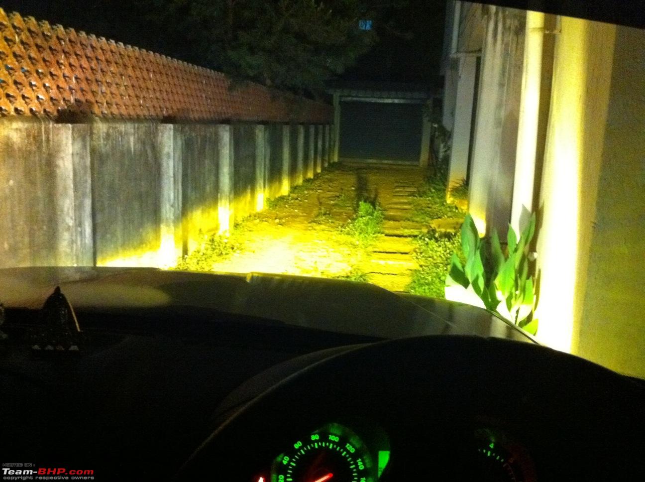

hi bhpians,
I had ordered a HID kit(4300K 55W) for my VW POLO TDI. I ordered it from OMGCAR2010.com and it cost me Rs.2800 incl. of delivery. On seeing the performance of the HID kit, I was very tempted to buy one for my scorpio fog lamps. so i ordered 55W H8 3000K for my scorpio fogs and the kit reached me and i installed it yesterday. For the scorpio headlamps i initially Ring Sports H4 100/80W. it lasted me for a year exactly. I wanted to get something more bright and i got Philips Rally H4 130/100W. i got them all installed Yesterday and the results have been phenomenal. i drove with the parking lights and fogs and trust me it lights up the road.
When installing the HID in my scorpio, i had to give it a dedicated switch as the OEM Fog switch that comes in the control stalk. The Ecu was cutting the power supply as it was of higher wattage(55W) and the OEM bulb wattage was 35W and hence i decided to put a switch. boy i am not disappointed at all.
i installed the HID as i am planning to go on a holiday and do a lot of travelling especially highways. i did the install in Power Zone, Royapettah.
i am very satisfied with the HID in my fogs. i have seen many scorpios here in chennai with HID in fog lamps but it was 6000K or more. it was mere bling and no performance.
so i took the plunge and am not disappointed at all.
ill let the pictures do the talking.
cheers
gk

Originally Posted by Guite View Post
There is a lot of advise against installing HID lamps on standard headlight, apparently because it blinds oncoming traffic. Can someone explain me why? Doesn't high / low beam exist in HIDs? For example in their webiste the Xenos HID light bulb is mentioned as "hi/low type".
I have been blinded many times, on a daily basis. I have always presumed that's because the other party is on high beam.
Originally Posted by Gocool2007 View Post
hi bhpians,
HID bulbs are arc lamps. Unlike halogen lamps that give out light along the length of the filament, the HID bulbs give out a point source - that too about 3 times brighter than the corresponding halogens.
The stock reflectors are not designed to reflect such kind of light.
So what you end up doing is just creating a LOT of public nuisance due to the glare created by these lamps. When you install these kind of lamps, I urge you to give a thought to the poor guy in the oncoming traffic who is getting insanely blinded due to your vehicle's glare.
The glare is painfully evident in the pic posted by you..
HIDs are meant to be put in projectors and not in reflectors, so spare a thought for others as well.
