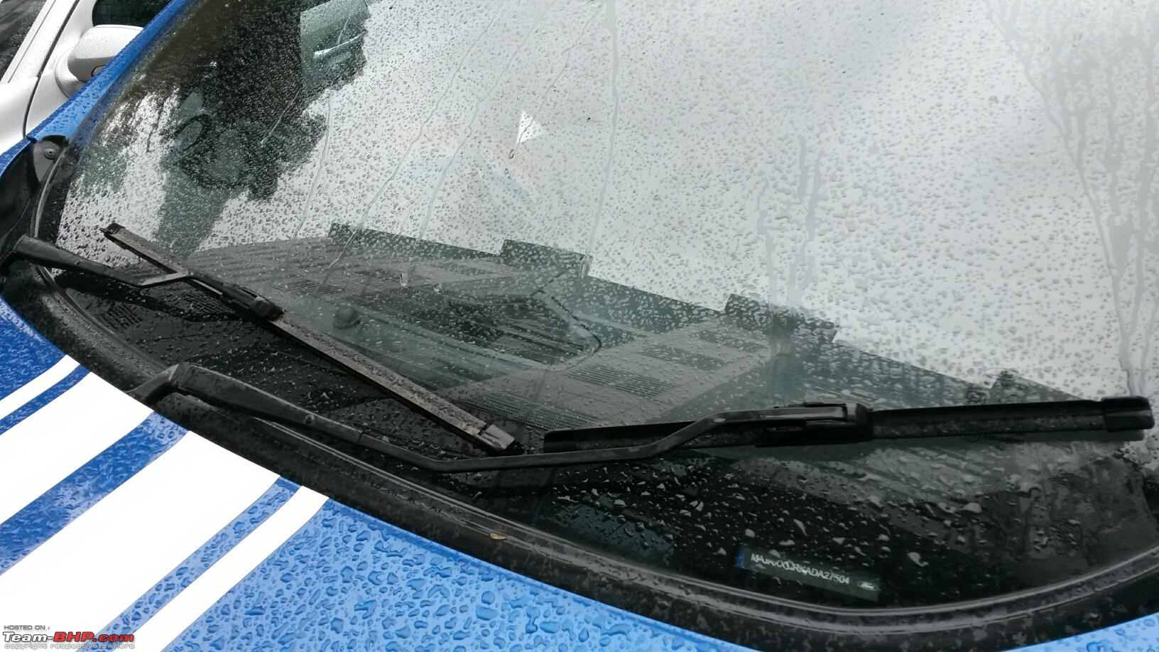

I have similarly used a 1" larger wiper blade on the rear glass also the specific blade was physically 1.5" larger than the original fitment and it did not foul any place,
ALSO
on the front windscreen
Increased the driver side wiper blade by 4" larger blade and used a proportionately smaller blade (roughly 3" smaller) on the passenger side.
Essentially ensure that the two don't foul with each other. Used the largest possible blade on the Driver Side that fit.
You gain significantly on the driver side especially if you sit high as earlier the original wiper left a large portion on the top of the glass uncleansed. The passenger side outer edge does now get cleaned a bit lesser but that is OK.
Do not order online but try it physically. Did this about 4 months back.
I tried to see if the inches are mentioned on the new blades but couldn't see it mentioned anywhere, hence not mentioning the exact size. I had also narrowed down the gap between the two wipers at that point of time so the decrease in the passenger side blade was not as much as the increase in the Driver side blade.
Can attach snaps if required.
Overall the visibility in rains is significantly increased.

Have attached the Snaps of the wipers as executed by me.
The Brand is something from china will last this monsoon only. Quality is average. Will get Bosch Aerotwins in this sizee when I get the time for it. They were not available when I tried 3 months back.
Front Passenger Wiper is 2 sizes bigger and the Rear 1 size bigger. These sizes work well for me.
You are also getting a sneak preview of the White Strips that I have got executed from 3M on my car.
Don't have the older wipers to compare sizes.
