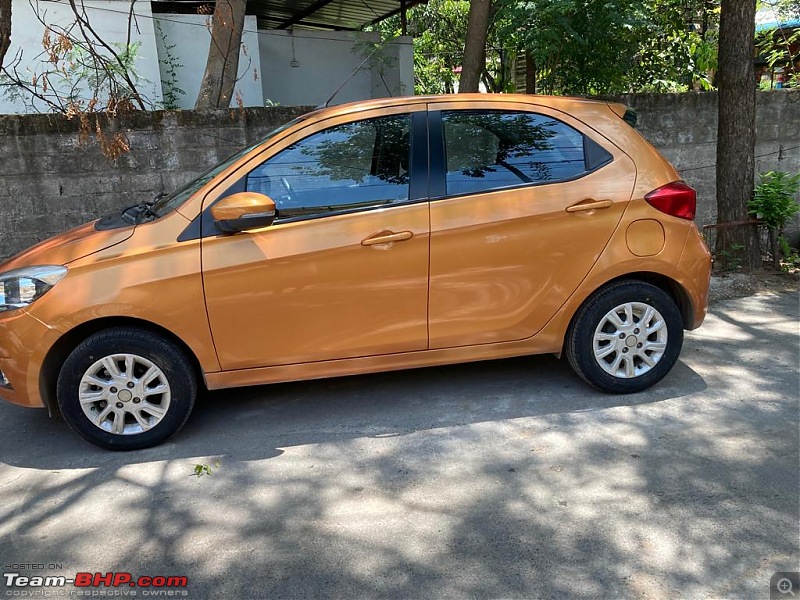

Our Tiago XZA completed its first major milestone in terms of kms a week ago.
Also turned 5 years old yesterday
Tata Tiago : Official Review-img_5842.jpeg
25k kms
Tata Tiago : Official Review-3ec8649f5f964af79f8ee21dc3a23893.jpeg
It has proven itself as a fairly reliable vehicle with average running cost. Suspension and other assorted things are aging well.
My father got the tires changed a couple of months back and it’s smooth sailing once again.
Opted for Yokohama
Tata Tiago : Official Review-img_5841.jpeg
Tata Tiago : Official Review-img_5843.jpeg
