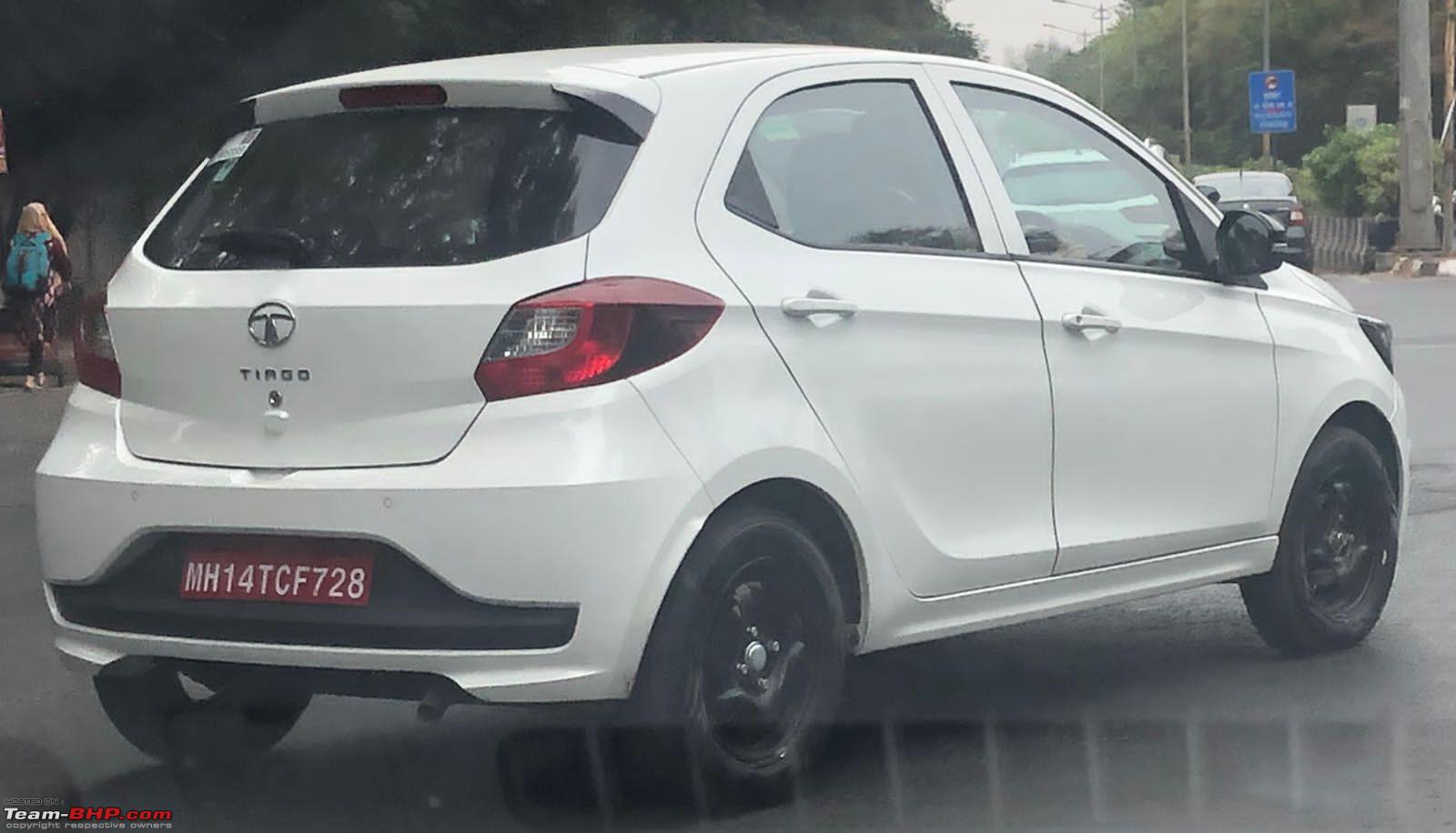

Caught on the streets of Pune a few days back by Autospy, sporting these wheels from the earlier NRG version.
A new Limited Edition on the cards?
