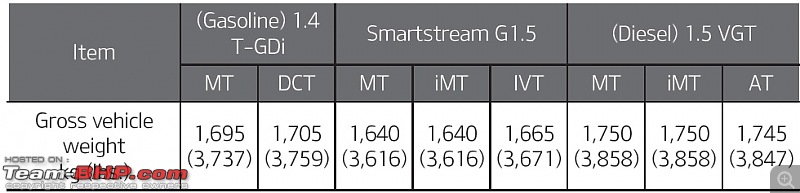

I just wonder why there should be a 100 kg difference between 1.5 NA and 1.4GDl manual when there is only a 50 kg difference between the 1.4 GDI and the 1.5 Diesel. All essential safety kit is the same across the variants, so assuming that structural changes next to nil. Is a turbo petrol engine that much heavier because of the turbocharger?
The weight difference between 1.4GDI and 1.5 NA is 55kg in Seltos. Similarly 1.5 Diesel is 55kg heavier than 1.4 GDI. One would expect a similar difference in Carens.
Moreover, gross weight of Carens should be Seltos weight + additional weight due to increased length + additional passengers. This logic also does not seem to hold good for the data available from the manual.
Most likely Kia does not publish the correct weights or does not proofread or is not concerned about weights at all. For instance, Carens diesel AT is heavier than MT whereas Seltos Diesel AT is lighter than MT.

Which country's Seltos are you referring to here ? As far as I know, there is no diesel IMT Seltos on sale in India.
Could be a typo by Kia. The picture is from the Seltos owners manual available at Kia India website - link
