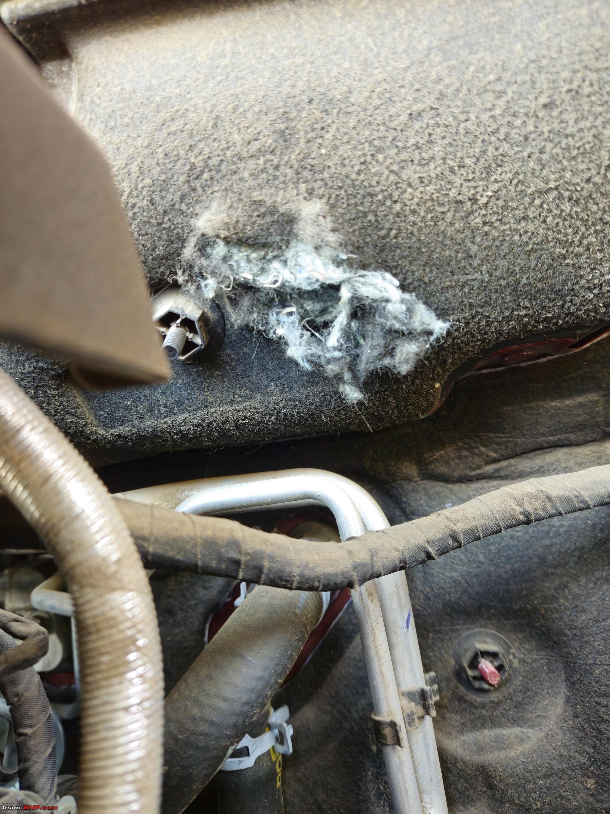

Not a good sight to see your car on flatbed, but it happened. While returning from Satara towards Pune after about 30kms OBD Telltale sign came up on screen and car lost power. It went into limp home mode and was not revving beyond 2200-2500 rpm. Immediately pulled over and stopped the car. Tried the restart method but the sign didn't go. Meanwhile had the OBD2 device plugged in so tried to scan for error codes. Got the below error related to turbocharger.
After this I got the DPF is clogged error which stayed for sometime and then went off mysteriously.
I also saw the foam padding bitten off by rat and suspected some wire cuts which caused this.
Service center checked for rat bites and did not find anything. They mentioned regeneration had failed which caused this issue. They did it manually and have returned the car.
