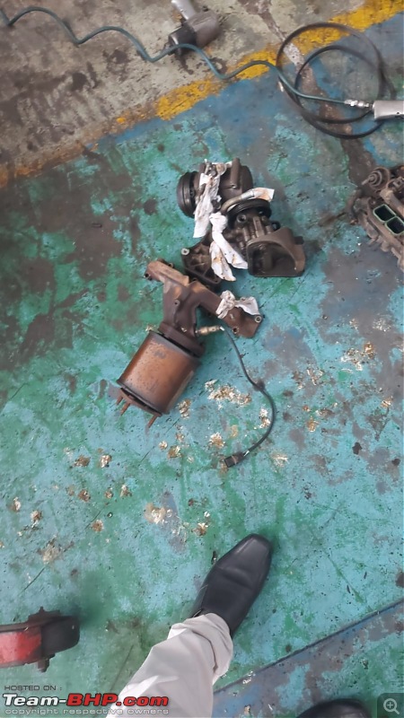

Hi all, My skiddz had a complete engine overhaul done availing "chevrolet promise camp" discounts!
I am planning to keep this car as beater car atleast for next 5-8 years and hence spent 80 grand on Engine Overhaul. The Car gradually lost pickup and struggled to pull post 185000. It started to consume oil, gave very bad fuel efficiency post 191000 kms. Finally at 193000 it gave up and started to breathe very badly.

193000- Engine piston parts change/Overhaul
All maintenance done with authorized dealer and always using Service camp availing 20% discount on parts and 20% discount on Labour.

Engine opened up!

The total bill came close to Rs 85,000 ( Actual 106,000 ) with camp discount of Rs14,000 for parts and Rs 6,000 for labour!
