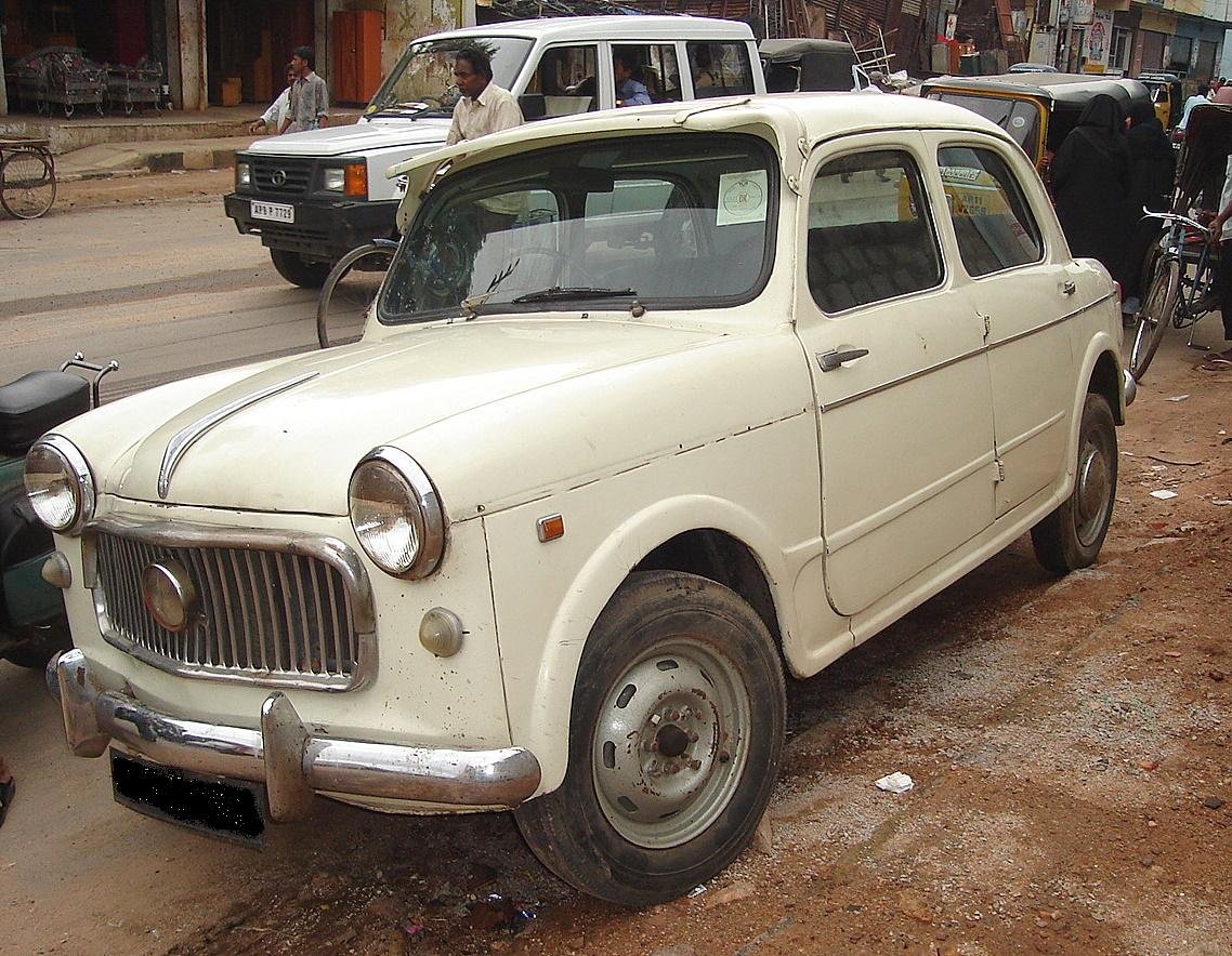

Friends, some of you might remember that I had, in the month of August picked up a 1957 Fiat Elegant at Hyderabad, thanks to Stanher (please check post #4 in http://www.team-bhp.com/forum/vintag...tml#post523767 for details).
The cars papers have finally come in my name and this has made me go full steam ahead to restore the car to it's ORIGINAL glory and would appreciate your views opinions and help if possible (in sourcing hard to find items etc).
Present condition of the car is that it is lying in a friends workshop totalkly stripped bare of its coats of paint and the inner revealed that the cars first factory coat of paint was black.
Here are a few pics of how it looked when I bought it, as posted by Shri Stanher:
