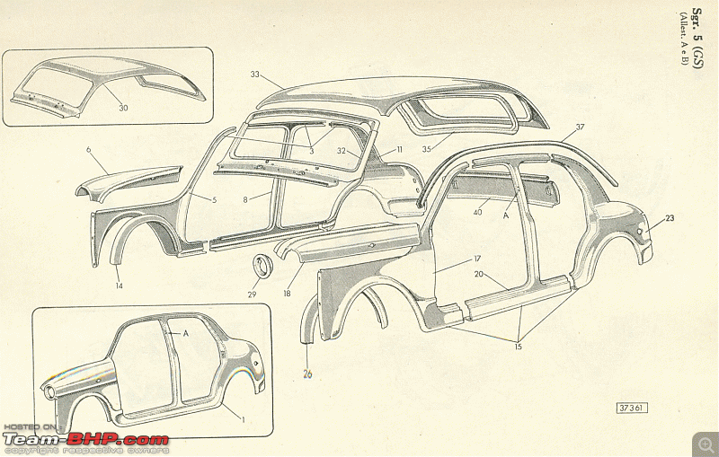

Would love to, in fact had procured a set of the complete left and right side of another car which had the smaller headlight fitted. Unfortunately, one of them went missing and there is only one side of it left. By any chance would that help in the restoration of Karl's car?
The part I am talking of is Item nos. 18 & 17 welded together though as in the drawing that you had posted and which I reproduce below:
If it would help in any way, I could try to locate, with Stanher's help of course the whereabouts of where we had left this piece and then probably rack our brains to see how we could transport them out of here. These parts came out of a Millecento which was trashed.

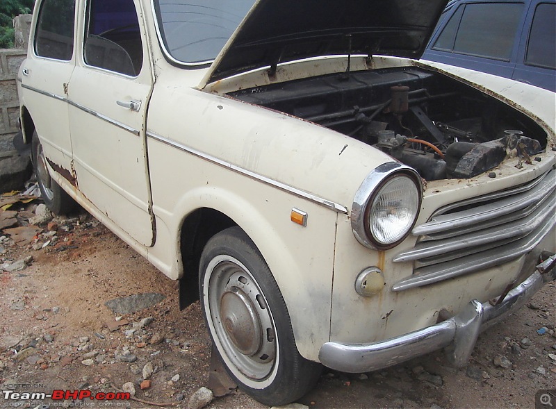

Aah, about time you reminded me of that elusive mudguard, suren!
However, I might point out that it certainly didnt have smaller headlights but both regular fiat ones.

Stanher, These came of the Black car if you remember well, and IIRC that car had the smaller headlights. It is the same car that I had the front facia removed from alongwith the sides that we are discussing now? Do correct me yaar if I am wrong.

Illai saar, these are NOT from the black 57, MDY 4547. Yes, you did take the front panel off that car (with the grille etc.), now fitted onto your car. But we did NOT take the mudguards off that car, they were from the above white millecento. And even MDY 4547 had bigger headlamps fitted, as seen in this pic.:
