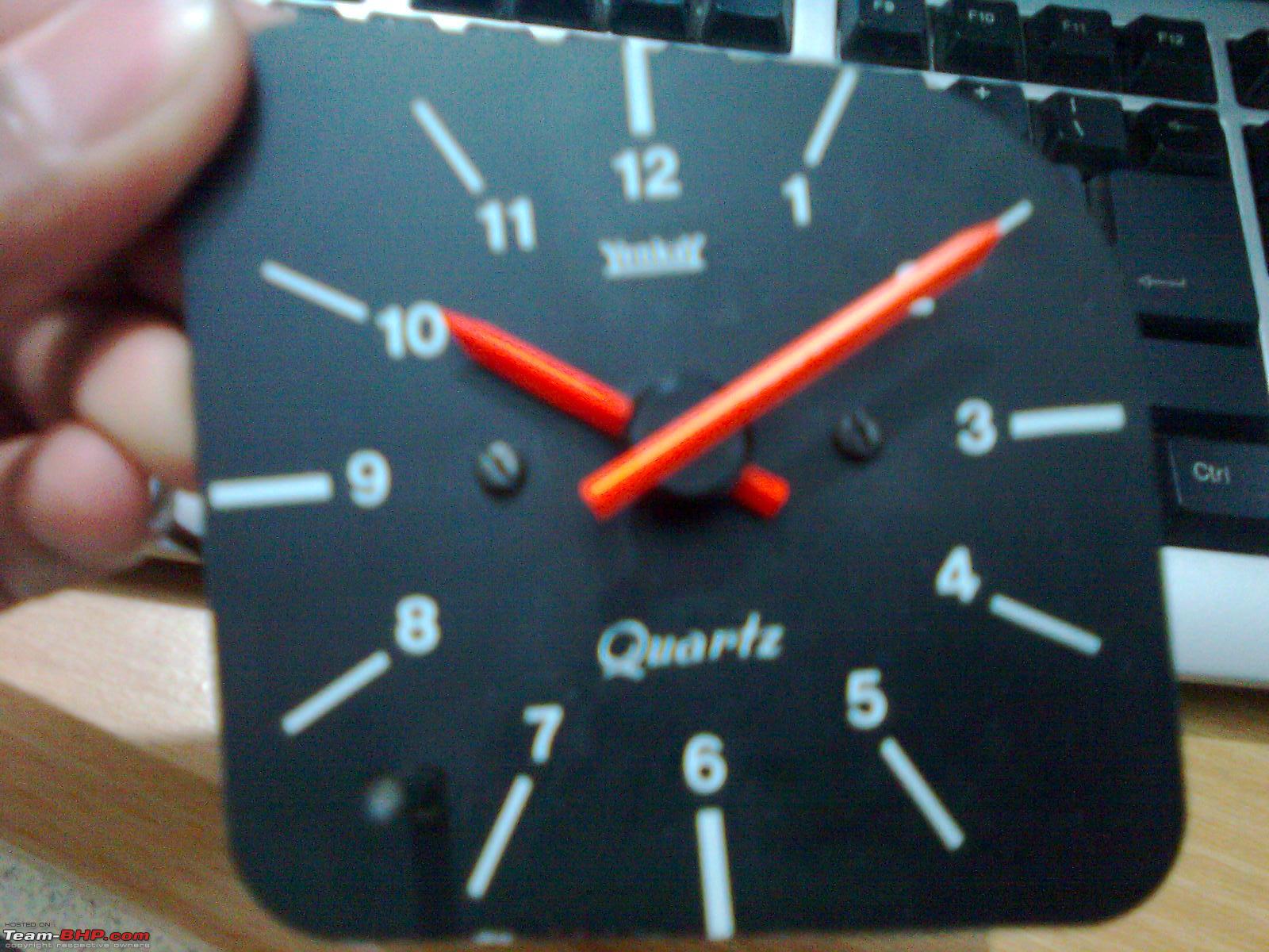

I have opened the clock Actually the whole meter for cleaning. See the pic. http://www.team-bhp.com/forum/attach...-image0064.jpg
Now i don't know at what volt will it move. The time adjust switch is not working as i have not powered the clock. Is it so or does it moves and at what volt will it move.
12V; Needle (when time adjust switch pressed) moves only when powered.

thanks a lot Ilango. Just wired up the clock and it works. The time can also be adjusted. I made a serial connection of 8 1.5v pencil cells and attached it to clock. See the pic.

Hey Karthik these clocks follow Quartz movement and hence last very long if not mishandled. The old mechanical clocks were prone to failure. I think you should also check the clock's functioning in both your cars as you stated none of them work.
