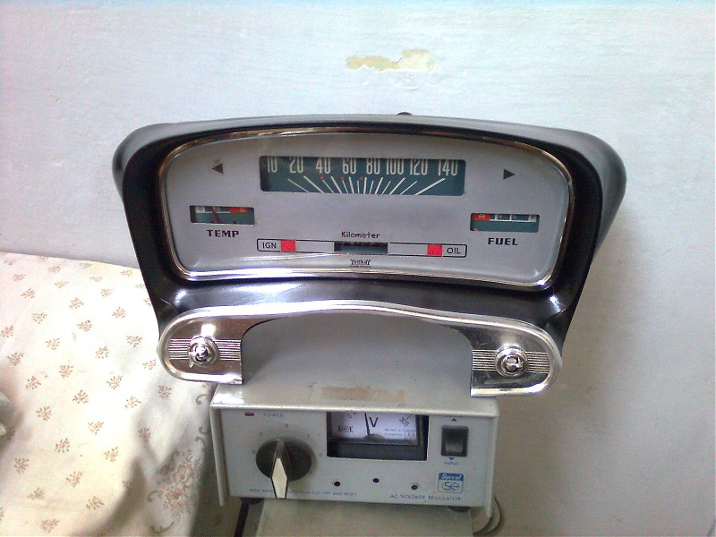

Recently i restored this meter which many of you know. I was wondering whether the temperature gauge cable is available in the market which is used in this type of meter. It doesn't have full cable with it. The wire is cut in half and i think cannot be joined. Whats the solution, can i get a new cable for it in the market. If yes then what is it called.
