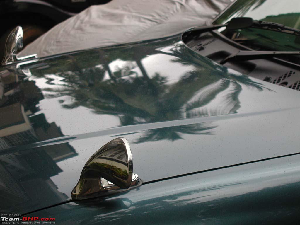

Here's the pictures after waxing with the abelauto liquid wax, there's a little smearing on the bonnet this because it began drizzling as i was taking the snaps and wiped it, 10 mins later we had a heavy downpour and the water was beading extremely well, the product is much better than i had expected, next test id durability, i usually wax every 4-6 weeks, time will tell though i'm pretty sure it will pass my test.
