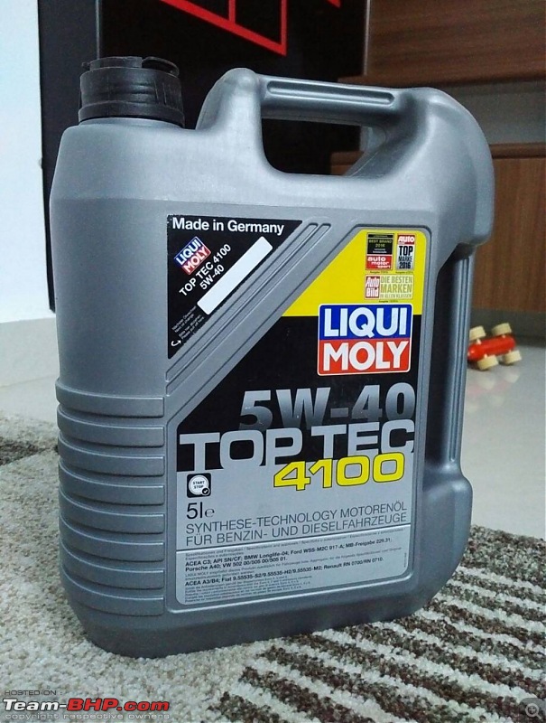

Old 25th February 2018, 08:32   #163
Auto freak's Avatar
Posts: 316
Thanked: 358 Times
Originally Posted by deepfusion View Post
Can you suggest some oils with 505.01.
There are not many oils that claim compatibility with 505.01. This is the one I used for my recent oil change. Liqui Moly Toptec 4100. Costed me approx 3.7K from Sparesncare.
Skoda / VW Group Engine Oils-1519527634404.jpg
Auto freak is offline   (1) Thanks
