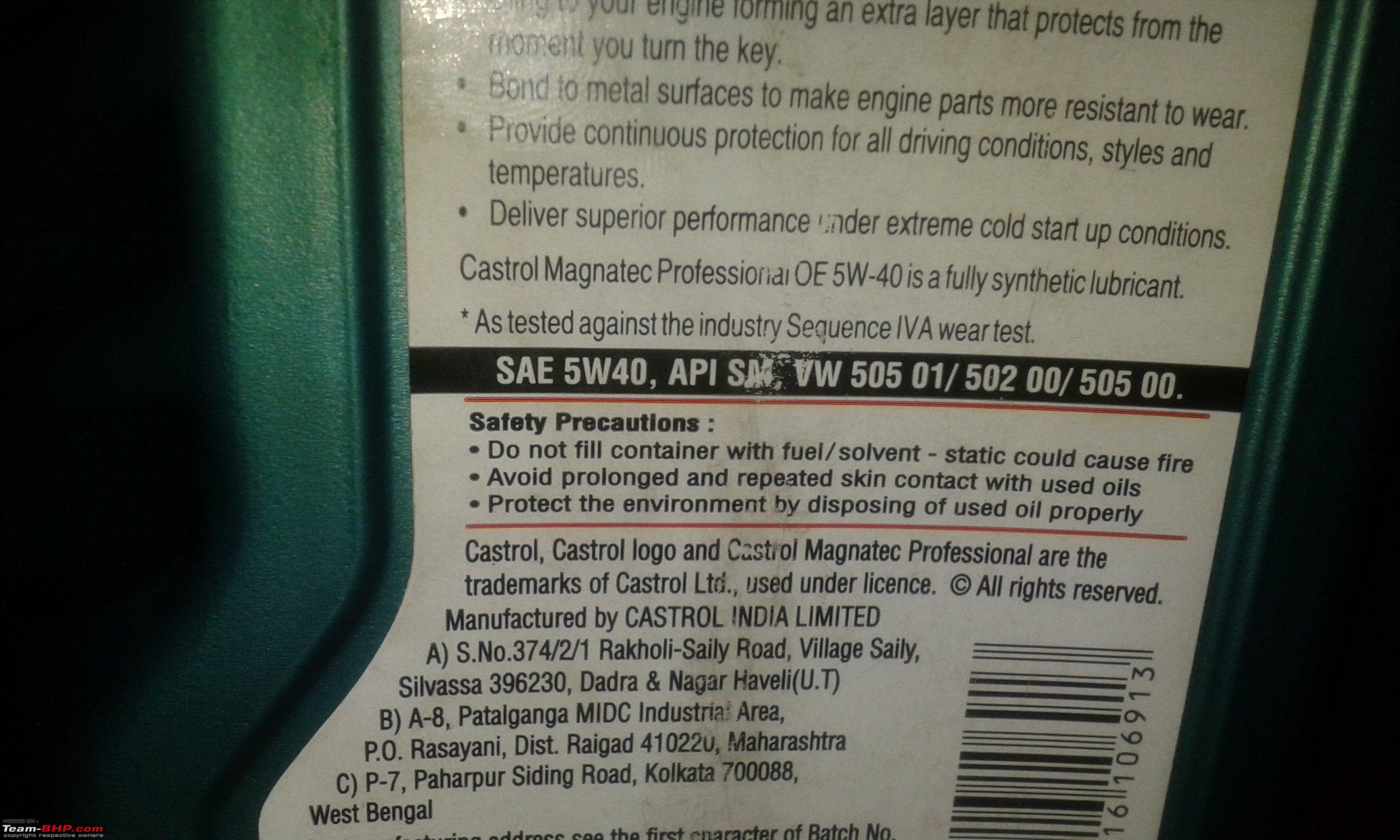

Dhiraj, its been a Big Sham!
The Castrol representative had sent a Mail saying that the Oil Conforming to 505.01 namely Castrol Magnatec B4 Professional is to be used.
I visited the Service Centre and it appears that the oil that is being used is Castrol Magnatec Professional VW 505.00. Attached is the pic of the Barrel. The spec sheets are in my Earlier Post
Skoda / VW Group Engine Oils-img_0169.jpg
Also my Service Manager informs me that he received a call from SAIPL confirming that they will be dispatching VW 507.00 Specification oils. So now where does the Hot Country Theory of Skoda India Go ? if these Oils were indeed to be used why the hurry in dispatching the VW 507 00 Grade oils ?
If you observe the user Manual that i have uploaded it mentions BS4/EU4/EU5, without DPF. when these specs are printed in the Manual and the vehicle is a CKD with Absolutely No indian Component going into the Vehicle who did the revision of the Specs? why did he revise the specs and were these revisions approved by Skoda CZ or the competent authority in the VW group abroad ? what about those vehicles which were wrongly filled with these oils ? The engine would have been damaged as per their caution in the Manual. will they extend the engine Warranty by two more years ? will they recall all the cars where this wrong grade oil has been used and replace the oil, bearing the cost of oil, filter, drain plug, flush ? what about those cars where the oil pumps have failed ?
Not quite. The oil being used is Castrol Magnatec Professional OE 5W-40, which meets an impressive array of specs, including VW 505.01 & MB 229.51. Here's its product data sheet: Link
with due respect to your knowledge on Oils, ETKA 7.3 Rev. 476, which the A.S.S. as well i have does not show VW 505.01 or Vw 505.00 as the Oil to be used in TDI Engines w.r.t to my Yeti or a friends Laura. It still does show that the Oil grade required is VW 507.00 - BTW The ETKA of the A.S.S. is homologated to India, Indian Prices
Please find attached the Spec Sheet of OE Professional which is no doubt 505.01 compliant,but is this the same oil that goes into your engine. The castrol that goes into your engine is Manufactured in India! Also please refer the Scan of User Manual attached in my earlier thread on the use of Oils.
catalogue-castrol-magnatec.pdf
Also if what you argue is Correct why is Skoda India informing the A.S.S. that The VW 507.00 Grade oil will be made available to order in a couple of days ?

Thanks for all the info shared. But again, Castrol, as with any other company for that matter, will look to localize and manufacture whatever they can within each country to save on costs. The spec that I shared in my earlier post is global, and not specific to any country. You could look up the specs here: http://msdspds.castrol.com/
The Magnatec Professional OE 5W-40 oil used by Skoda & VW in the workshops is VW 505.01 compliant without a shadow of a doubt. Feel free to visit a Castrol distributor and confirm for yourself; look at the Drums (which are sold in bulk to VW/Skoda) & 4L/1L cans (that you can buy from a dealer or at any VW/Skoda workshop for DIY top-up). Suggest we move on and focus on why they switched to 505.01 from 507 for India.
Attaching pictures from the 1L bottle that I pick up regularly for top-up. Cheers!
Skoda / VW Group Engine Oils-20130102_000709.jpg
Skoda / VW Group Engine Oils-20130102_000730.jpg
The Photo of the Labelling on the Bulk Supply Barrel was attached in my earlier post. That was clicked from the Skoda A.S.S. As regards the Castrol Distributor he has been totally clueless about VW 501, 502, 505, 501.01, 504, 507 and he just knows about 5W30 and 5W40. also when i obtained the Spec sheet of CMP OE 5W40 from the link you provided it said 'Claims to meet the following standards'. there is quite a difference between 'claiming' to meet a particular standard and 'conforming' to a particular standard.
We are not here to debate as to who is right and who is wrong. we are here to find out why 505.01 is specified to be used and is being used, even though my user manual says its 507.00 which is the recommended grade for EU4/EU5/ BS4 / Non DPF Engines. BS4 is an India Specific Standard and definitely when the Manual was printed by VW/Skoda they had considered India and Indian Conditions and thats why BS4 finds its mention there. if i were you, i would be thinking twice while even doing a oil change or top up, after i read the cautionary notes about engine damage in the user manual. if the specs did indeed change, then why arent our user manuals changed / corrected ? or an addendum attached ? since it is claimed that the specs changed in 2011 and we bought our cars in Mid 2012.
Also since the L,S,Y are all CKD's and on an earlier instance, when i had sent a mail to the technical Team to SAIPL about installation of Bluetooth, Auto Headlamps, they said their technical experts cannot modify the Specs of the CKD's. and here they have modified the Oil Specs. who cares after your engine/ oil pump fails after the warranty period ? Skoda will Still make money from the repair job!
Now just one last lingering doubt. If they were all along on the right, why are they arranging to send the VW 507 00 Specification Oil to the dealerships 'for those customers who demand for it' ? why did they have a sudden change of heart ?
