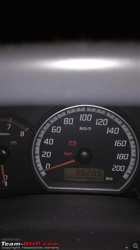

My 12 year old Swift didn't start now. When I turn the key the normal starting sounds didn't happen. It wasn't like when the sounds happen but it's still enough to start the car. I drove it in the morning & parked it - it was fine then.
The battery symbol on the panel does light up?
The battery is quite old - I think may be 6-7 years old (I drive the car only once a week for the last 3 years).
Is this the battery conking off or can this be something more serious?
4~5 Years is the maximum lifetime you can squeeze out of a Car battery, 3 is ideally when you should get it replaced for a reliable user experience.
Change the battery and keep us posted.

Sure. But does this sound like a battery issue or something else?
I presume so because you've mentioned the age of the battery.
If say the battery was new and the issue still occurred then first thing I'd look for is whether the Immobilizer light is lighting up.
If not then I'd turn the car OFF and then turn the ignition to ON and observe for the fuel pump priming sound coming from under the rear seat of the car, if nothing comes then I'd start with checking its fuse.
It is highly unlikely that the fuel pump would prime alright and the car would still refuse to start without the CEL popping up.

My 12 year old Swift didn't start now. When I turn The battery symbol on the panel does light up?
Most likely battery is dying/dead. The best thing you can do it test the car with another battery and get the current one tested. A trickle charge may be all that is needed, though if you only keep using the car once a week for a short distance/time, it may need to keep doing trickle charges if you intend to keep it

Called Exide Batmobile. They came & checked the battery & said that the charge is only 10.75. They helped me start the car by connecting the battery to theirs & my battery immediately started charging. I showed a charge of 14.75 within minutes. He said I can charge it & use it but I took it to the shop & got a new battery. This battery was very old.
