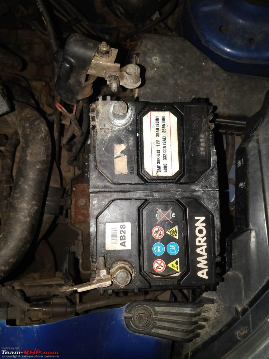

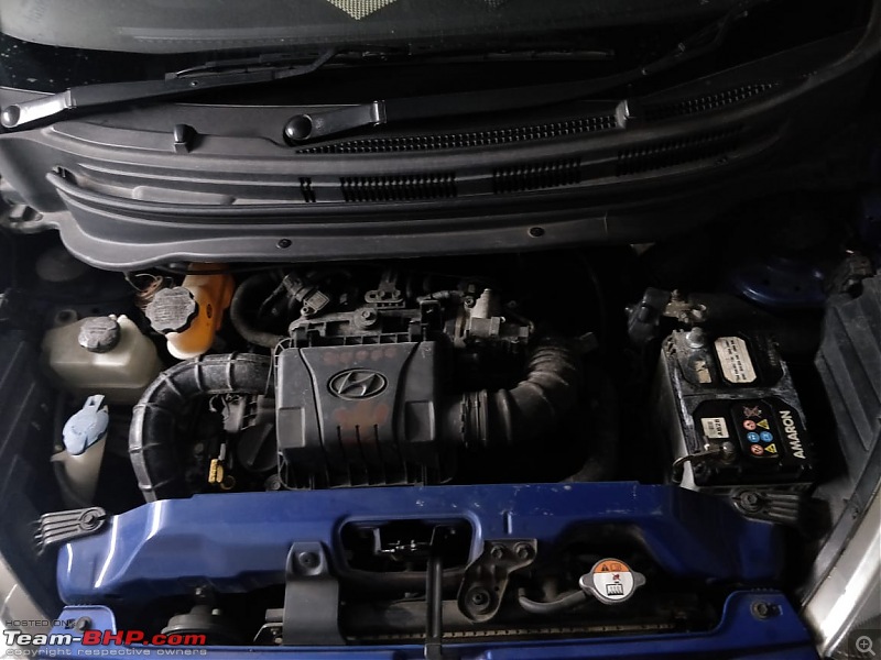

Hi veterans. My 5 yrs old eon dlite+ is having trouble starting up, of late, especially during the last few months of disuse due to covid restrictions. Although we try starting the engine once in 2-3 days or keeping the battery terminal open. It starts on jump starting the engine in a second though.
Please suggest what might have gone wrong.

While running the car in idle for a few minutes a day helps in trickle charging it, doing that alone won't help it retain full charge. You may want to jump start it and run for about 25-30 kms and check. If that doesn't help, you may want to have the battery health checked.

Sirs, on ignition the lights turn on and stay on, the radio plays too but the engine dont start. I read somewhere that it might happen due to the water levels in the battery being low or if its leaking which might be indicated on deposition of salt around the terminals, which is there in my case.
Also I had similar problems before when it was found to be rat attack. Is it a possibility this time too, although i have changed states since then!
On jump starting the car starts just in a second and keeps running byt once in a while stops again midway even if not more than 500 m away.
So if the battery is culprit or not, is it worthwhile going for the maruti jumpstart pocket battery which can be handy or dealing with the car itself would be worthwhile?
Please advice.
