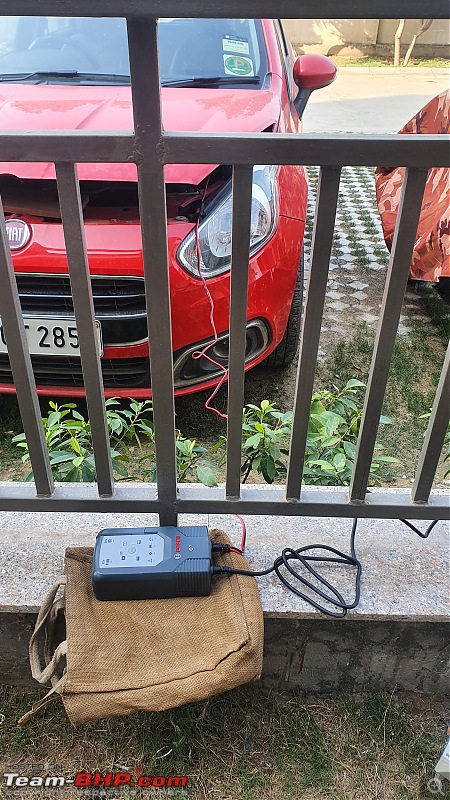

Originally Posted by man23ish View Post
A friend of mine from Pune has Fiat Punto Diesel 8.5 year old with 60k run. Below is the issue he is facing -
"Couple of days back I started the car early morning and drove for around 7-8 kms and stopped for some time.
Please note I have never ever done any servicing outside of the Fiat ASS but the service center is around 35 kms from where I live as Fiat closed the other workshop in Pune during covid.
Kindly help/advise!! "
I also have a 2015 Punto evo MJD and unfortunately had the exact same issue. The car was working fine, but suddenly, it just stopped cranking. Got a push from some people on the road and went to my mech. He diagnosed it with two aspects, either the carbon bushes in the starter motor have worn out or there is an issue with the alternator.
The started motor was disassembled and the carbon bushes were the culprit. They checked the alternator as well but it seemed to be running fine.
Finally, the bushes were changed with the total cost of Rs 1250/- and since then there have been no issues.
Just for the sake of maintaining the battery well, I also got for the bosch C7 charger (as running is not so much post the pandemic scenario) and it has been a boon.
