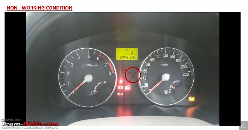

Hello , I have a similar problem. Details below -
My Hyundai verna 2009 sx vtvt 1.6 model (petrol) is having a strange issue. The immobilizer light in the dashboard works fine when starting, then vehicle runs for 4-5 mins and shuts down. After that immobilizer light doesnt work and vehicle doesnt start upon ignition. If I try after 4-5 hours, it again works but only for 4-5 minutes. Is this a problem with the ECU or the immobilizer or something different? Pics attached
