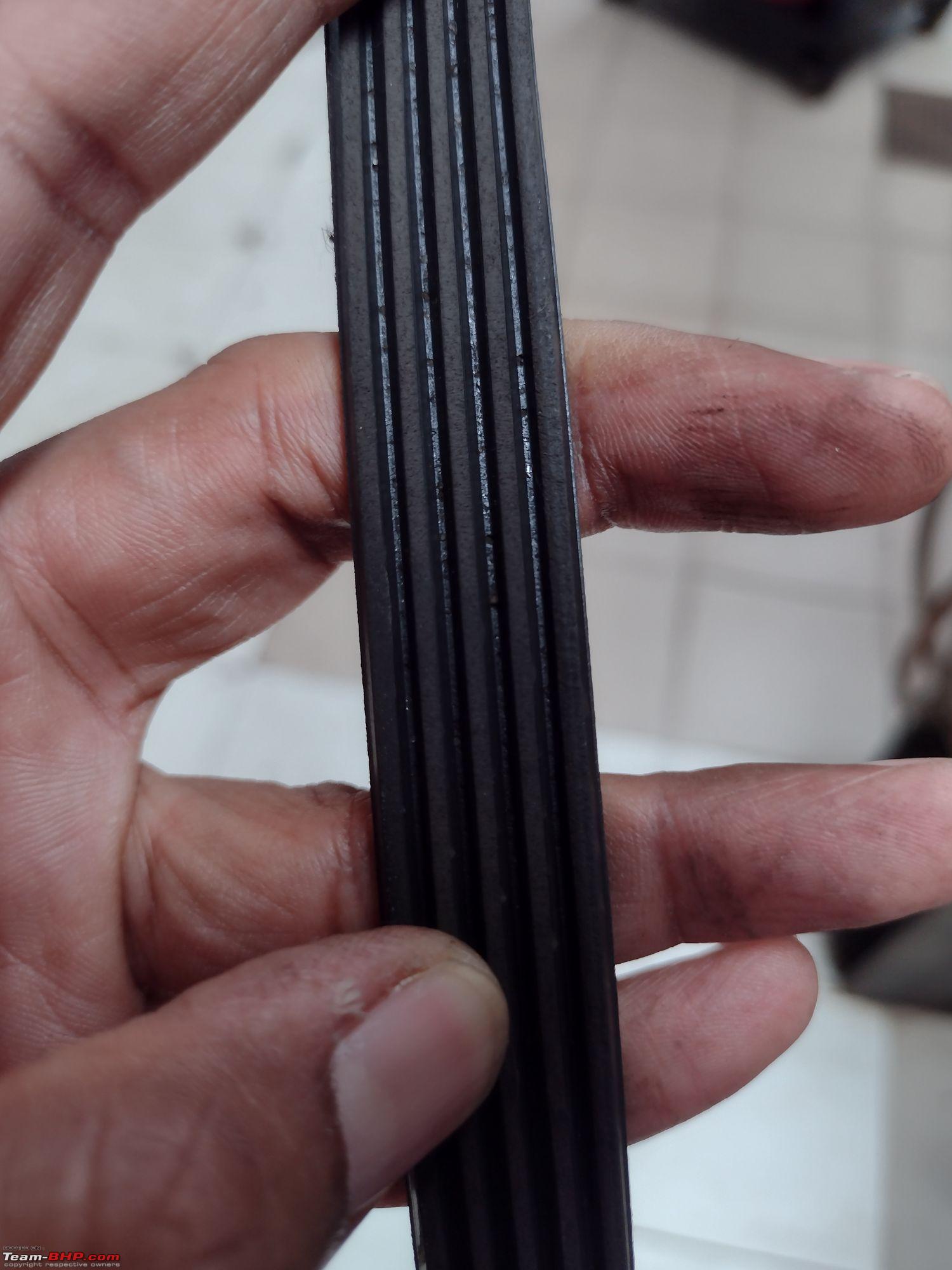

The alternator belt was changed proactively though it looked in good condition. AC compressor belt was not changed.
