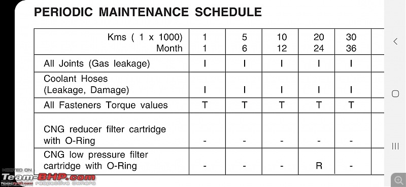

Some time back you had updated with the part number of the CNG filter of 2016 Wagonr but in the CNG manual there are two filters and the car also some times stalls even after changing the filter. So if it is possible can you check if 2016 Wagonr CNG comes with 2 filters, if yes then the part number of the second filter and if possible the location as the MGP outlet here was clueless and so is my FNG. Thanks in advance.
Maruti Genuine Parts (MGP) Catalog: Post your queries here (model list on Pg 1)-screenshot_20190821065929_drive.jpg

Hey Buddy, apologies for not being able to help you earlier. Blame it on my relatively low knowledge of CNG models. Nevertheless, thanks to your persistent nudging, I actually went through CNG's service manual to see what all the fuss is about!
Originally Posted by revvharder View Post
Hi Shashi sir,
Definitely there are two filters in the CNG line, but the MGP Parts manual mentions nothing about the 2nd filter. After searching the entire CNG manual, this is what I got to learn. One is a normal CNG filter, whose part number I have mentioned in past and will again mention. The other is actually inside the pressure regulator. But the issue is, there is no mention of the filter in Parts manual(AFAIK, and hence the delay).
However the service manual speaks about replacing the filter, o-ring and springs, which gave me hint that probably MSIL sells it as some kit. And that was exactly the case.
Attaching a pic of the process of regulator filter removal from the manual. However be very careful while handling the regulator because if you somehow manage to ruin it, its replacement part will cost you around 22k.
So to conclude, there are two CNG filters:
1. Normal one:
Name: FILTER COMP CNG
Part No: 15410M67L70
Price: Rs 1050
2. Regulator rebuild kit
Part No: 15616M67L70
Name: OVERHAULING KIT CNG(FILTER SPRING A
Price: Rs. 1275
Shashi
