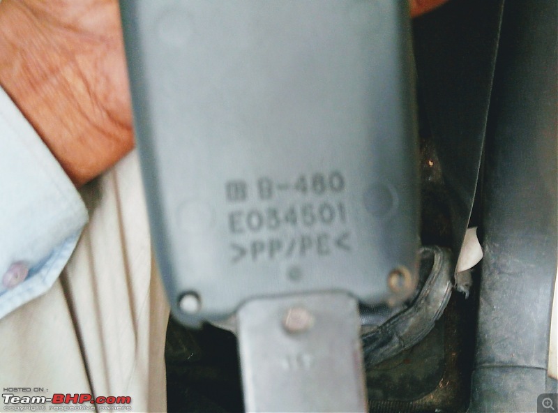

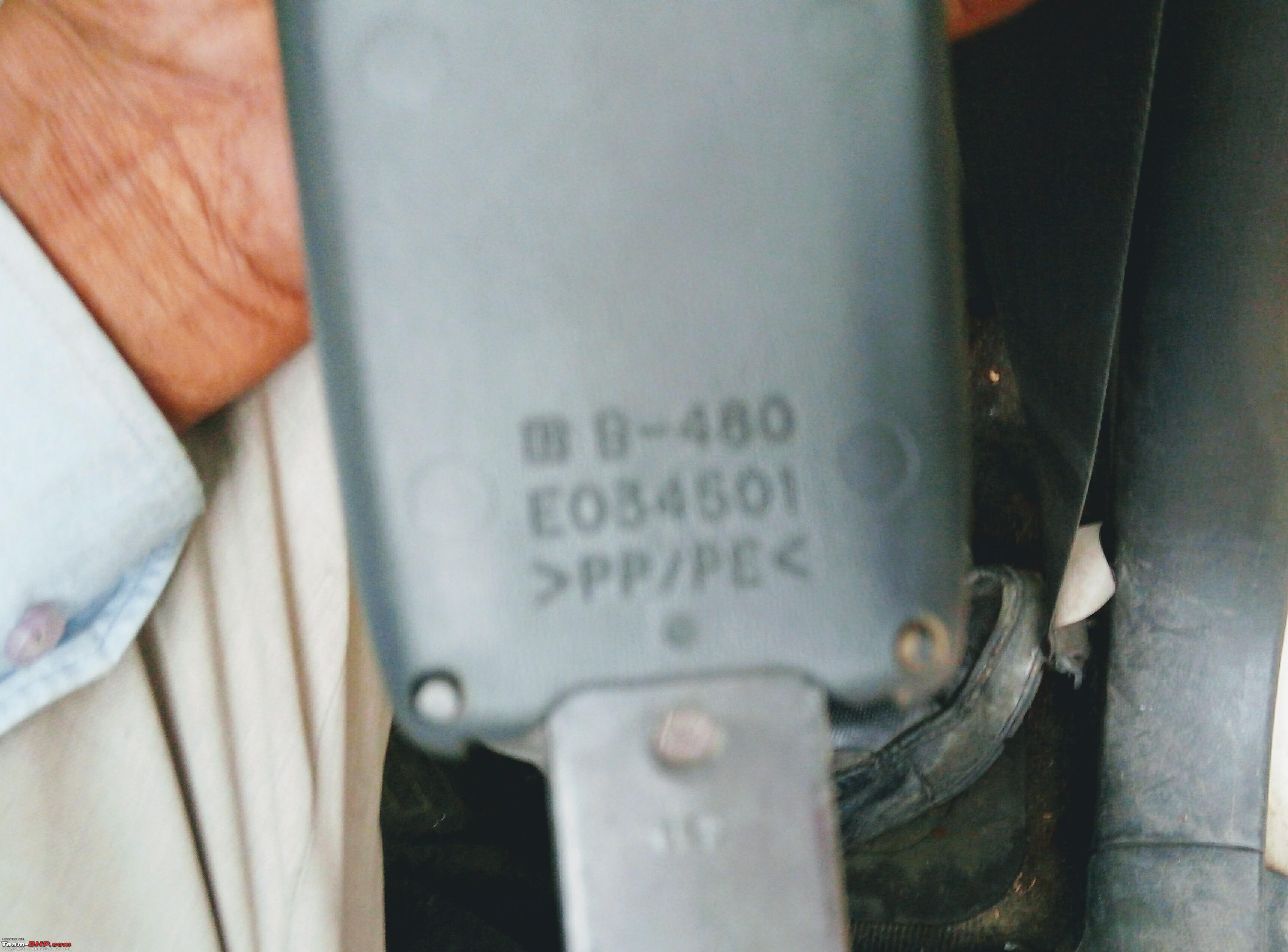

Dear Shashi and anyone else, I need to know how to get this part - the driver's seatbelt female portion from my 1st-gen Swift. The seatbelt-on indicator switch inside has gone kaput, the dashboard seatbelt warning light refuses to turn off, and since the contact is on a PCB which has worn out, repair isn't possible. Apart from the irritation of a blinking light on the panel, I suspect the airbags would remain deactivated if the system reads that there is no seatbelt on.
The part number as printed on the unit is B-480 E034501, but I am unable to procure it in brick-and-mortar shops, without changing the whole seatbelt set (as advised by MASS).
Maruti Genuine Parts (MGP) Catalog: Post your queries here (model list on Pg 1)-img_20170810_140225.jpg
Maruti Genuine Parts (MGP) Catalog: Post your queries here (model list on Pg 1)-img_20170810_141327.jpg

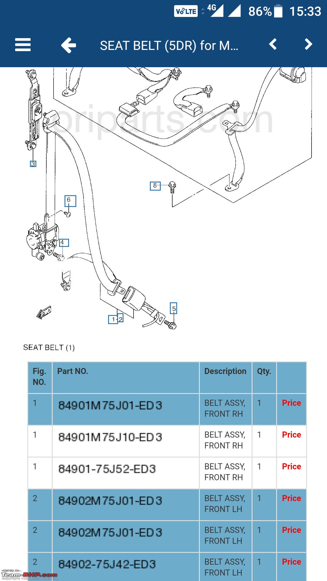

Dear SST Sir, checked for the part number for the seat belt:
Here's the image
Maruti Genuine Parts (MGP) Catalog: Post your queries here (model list on Pg 1)-screenshot_20170812153323.png

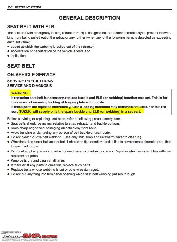

Sir, unfortunately, you'll have to purchase the whole driver side seatbelt assembly. MSIL doesn't supply child parts for restraint systems, and they have mentioned this in their workshop manual too:
Maruti Genuine Parts (MGP) Catalog: Post your queries here (model list on Pg 1)-capture.jpg
You can also look in scrapyards for the same.
That looks like the internal part number or batch number for the vendor. The correct part number for ZXi will be:
Part No: 84901M75J10-ED3
Name: BELT ASSY FR R
Price: Rs. 1267
This is MGP (localised assembly). I have a feeling that the assembly which came with your car was SGP. The seat belt unit has its vendor details written at its bottom part, which meets the B-pillar end. So here are the details of SGP, in case you decide to purchase them.
Part No: 84901-75J52-ED3
Price: Rs. 14391
Shashi

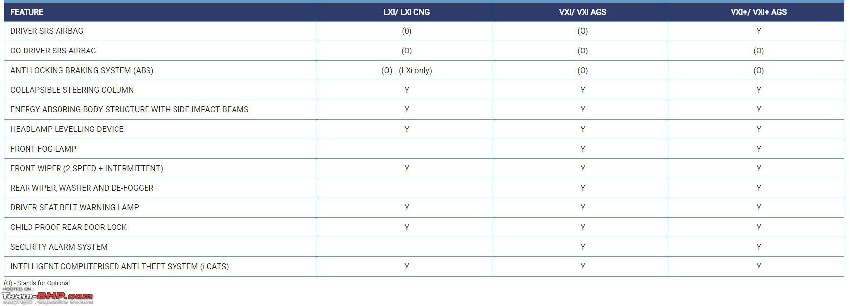

So every airbag-equipped Maruti vehicle has SRS AIRBAG written on the dashboard & steering wheel? Or do some just have AIRBAG on them?
Originally Posted by Ramon View Post
All Marutis equipped with Airbags have always come with Seatbelt Pretensioners on the front seats.
Let's consider the cheapest car in their stable, the Alto. It gets only driver side airbag, and has SRS AIRBAG written on it. It doesn't get any pre tensioner though.
Maruti Genuine Parts (MGP) Catalog: Post your queries here (model list on Pg 1)-marutialto80003.jpg
Shashi

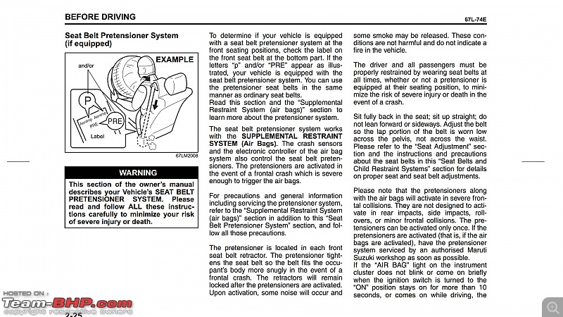

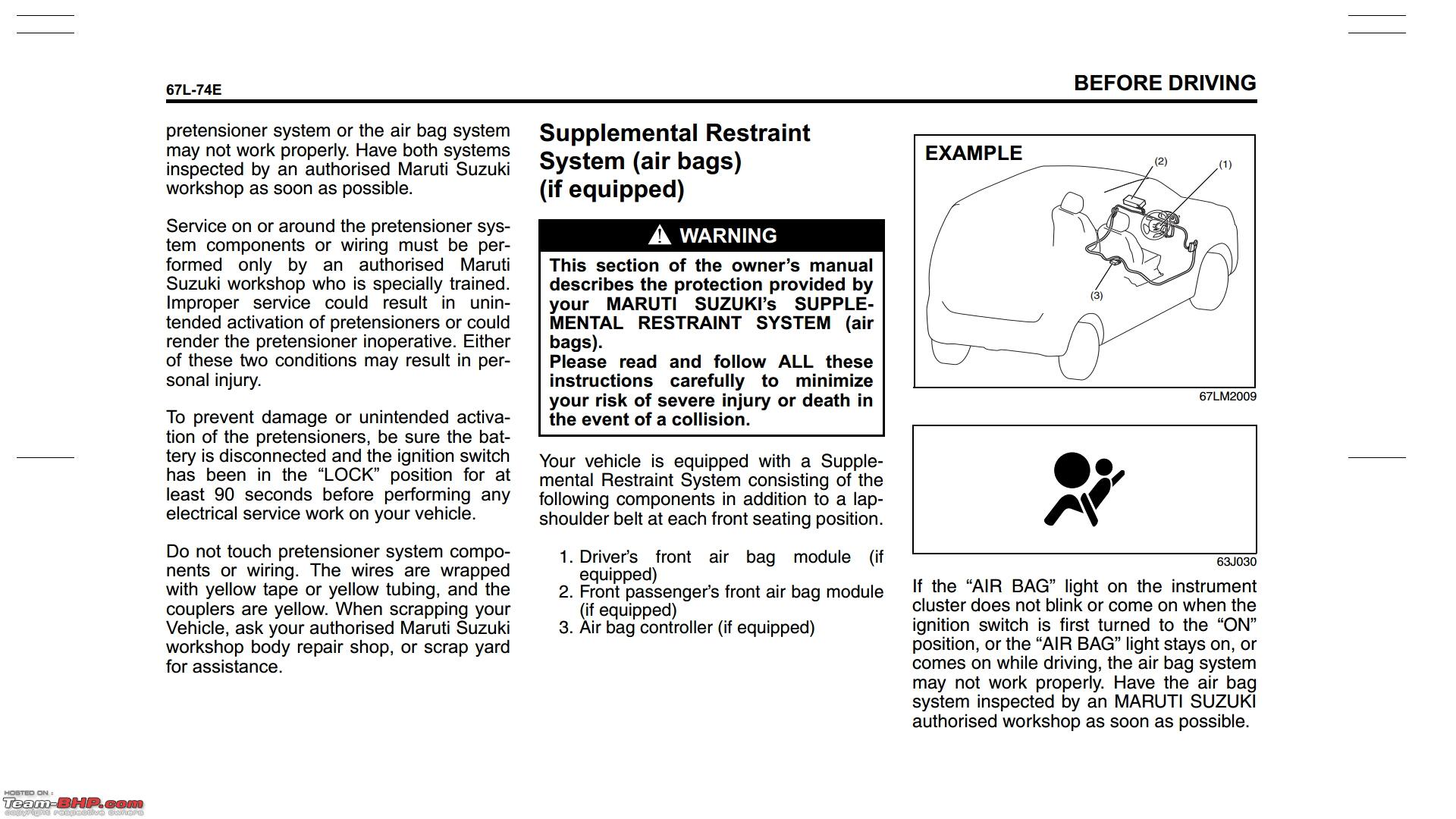

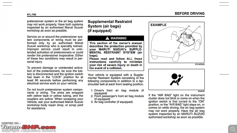

Well, seems to be a recent deletion.
Attaching herewith screenshots from the softcopy of the Owners Manual of the Wagon R which I had downloaded last November. It clearly mentions the Seatbelt Pretensioners.
Now the latest owners manual available in the Maruti Site doesn't have this section.
Seems like with the recent variant shuffle and minor facelift + launch of the earstwhile Stingray as the Vxi+, the pretensioners has been silently been discontinued by Maruti?
Don't know about the Celerio. Anyway I will check the Wagon R Owners Manual hard copy when I get back home.
Maruti Genuine Parts (MGP) Catalog: Post your queries here (model list on Pg 1)-screenshot_20170812210946392.jpeg
Maruti Genuine Parts (MGP) Catalog: Post your queries here (model list on Pg 1)-screenshot_20170812211030575.jpeg
