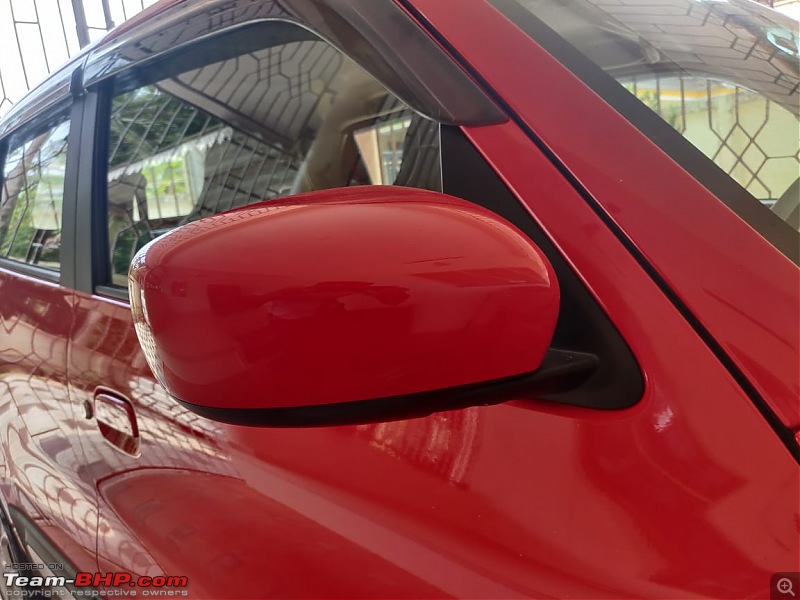

Hello Shashi,
We took delivery of S-Presso VXI+AGS last week. This was intended for my sister who is still learning driving. On the very next day after taking delivery, an accident occurred where the right ORVM collided with ORVM of an Innova (Yup...It happened. This car is quite high). While nothing happened to the outside shell (just a minor scratch in clear coat), due to the impact the mirror inside fell off.
We enquired with different Maruti dealers near our area and none of them had the mirror available with them. It had to be ordered and they said it would take 7 days. But now even after 7 days, the part has not yet come and also they are unsure when it will reach here since it has to come from Maruti. Even the registration of the vehicle is on hold due to this issue.
Does the mirror from any other Maruti models suit S-Presso? The model of mirror is one with an internal knob to adjust. Only the mirror came off and the mirror assembly is fine. Any help would be appreciated.
Maruti Genuine Parts (MGP) Catalog: Post your queries here (model list on Pg 1)-whatsapp-image-20210301-2.25.24-pm.jpeg
Maruti Genuine Parts (MGP) Catalog: Post your queries here (model list on Pg 1)-whatsapp-image-20210301-2.25.33-pm.jpeg

Hello there. Sorry about the incident. But this is available.
Part - 84730M67P10 Right side mirror glass only.
Costs 220 as per boodmo
https://boodmo.com/catalog/part-glas...mir_r-51803297
Hope this helps.

Does the mirror from any other Maruti models suit S-Presso? The model of mirror is one with an internal knob to adjust. Only the mirror came off and the mirror assembly is fine. Any help would be appreciated.[/QUOTE
Celerio's or Alto K10's glass should match with S-presso's.
