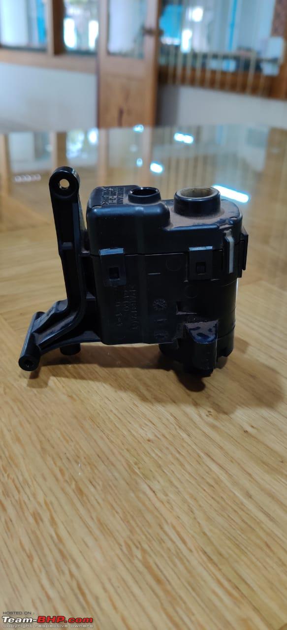

Hello. Looking for the motor inside the left side mirror on my Ciaz Zdi+. Everything else is working fine. Only gear is broken.

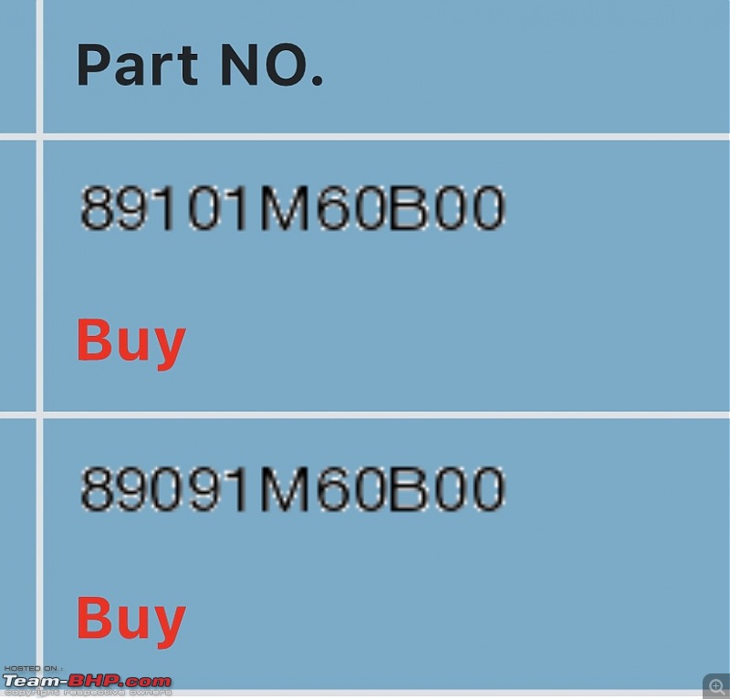

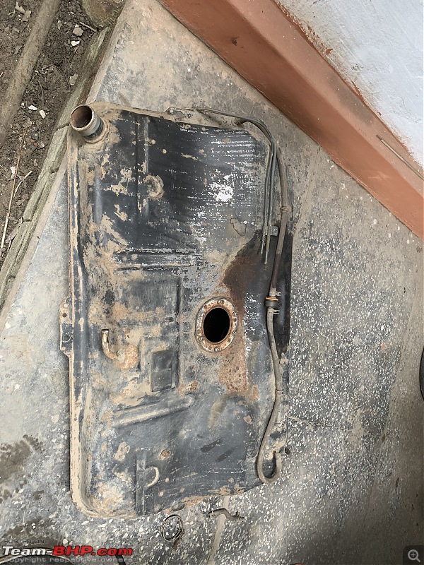

I am currently trying to revive my 1995 carb Esteem and need to order a new fuel tank for it. However, boodmo shows two part numbers corresponding to the fuel tank assembly. Could you please guide me as to which of these is the correct part number for my car?
Unfortunately the motor isn't available separately. You'll have to buy the entire mirror assembly or hunt for motor in aftermarket/scrapyard.
You need to order 89091M60B00. Both belong to same family, but 89101M60B00 is discontinued. Production of 89091M60B00 has been stopped too but Maruti has some left over stocks of the same which you will get.

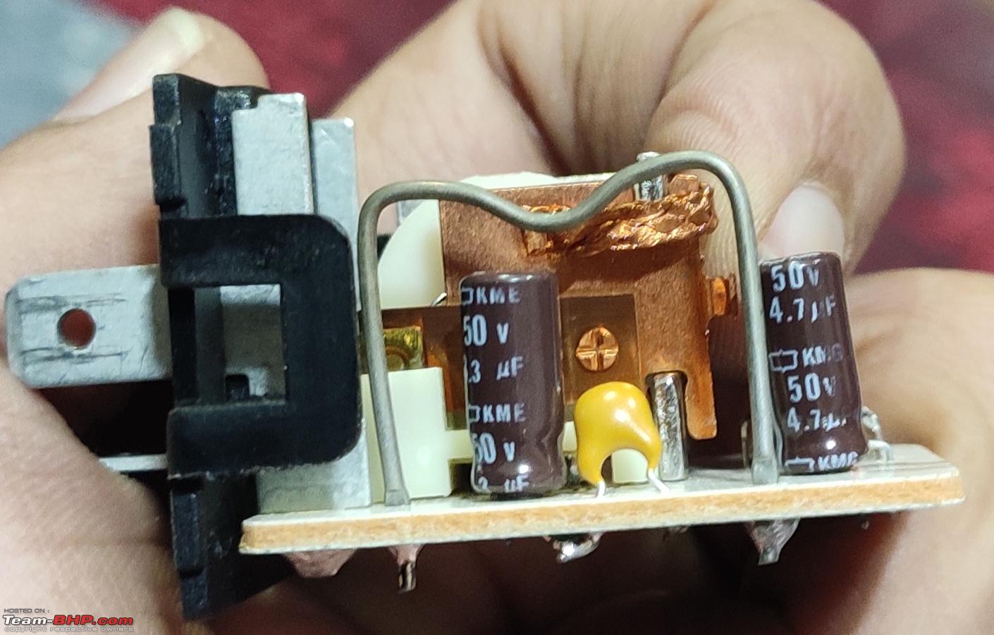

Here are some pictures of the internals of the relay that was replaced.
The spring has come off its joint at the point marked in red. That could be the reason for the relay's failure.
