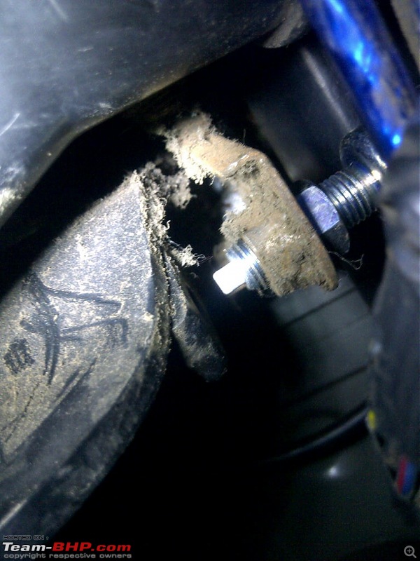

i got an autocop tech. give me a new remote and tune it earlier today and everything was good. in the evening i took the car out to go somewhere and when i parked the vehicle i noticed that the tail light (brake light) was always ON; i have parked the vehicle with negative terminals of battery disconnected so that the battery doesn't drain out. i'll check the brake switch (brake switch was changed 4-5 months ago, so it must not have gone kaput) in the morning if i could fit in that space to have a look, anything else that i should check?
also, before disconnecting the battery, i tried to disconnect the brake light by removing the sockets but could not locate the connection for spoiler, anybody knows where is it?
somehow squeezed into that little space under the dashboard and had a look; the rubber beading that exerts pressure on the switch when brake pedal is released had gone. as a temporary measure, i have clipped on one of the stationary clips (which is used to hold the documents together) to the metal pedal and is working good.
Photograph for Reference showing brake pedal (slightly depressed position) and the brake switch.
Same thing happened on my OHC 1.5Exi in Nov 11, my brother took it to Peninsular Honda in Kollam and they replaced the switch near the brake lever (inside cabin). I dont remember the cost though.
