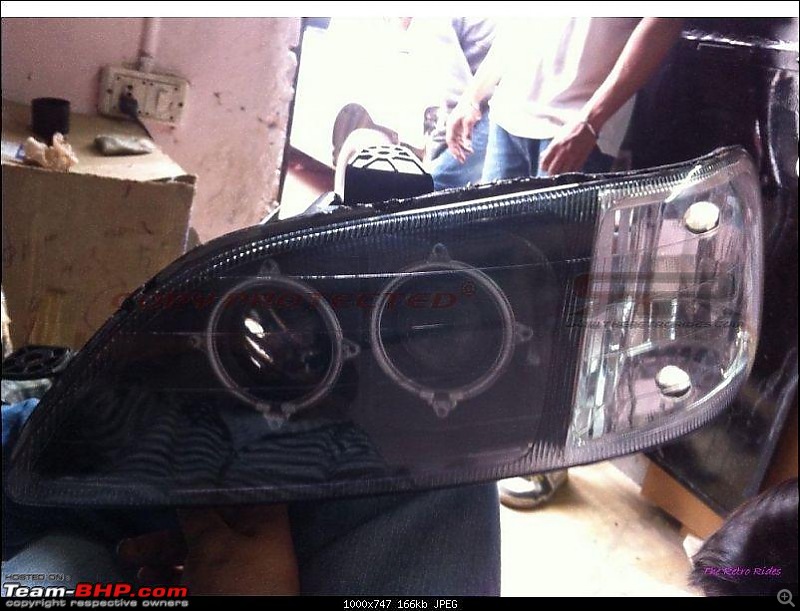

Looks great Ryan. Nice work. Do make sure that water doesnt seep in.
I feel the for the OHC, the double projector setup looks even better and nicely spread out within the headlight assembly. I think retro rides in delhi had made one such projector lights for the OHC.
1st Gen Honda City Owners - Problems Areas, Fuel Efficiency and more-ohc-projector.jpg
Desmosedici is offline   (1) Thanks
That would cost a bomb for sure!
