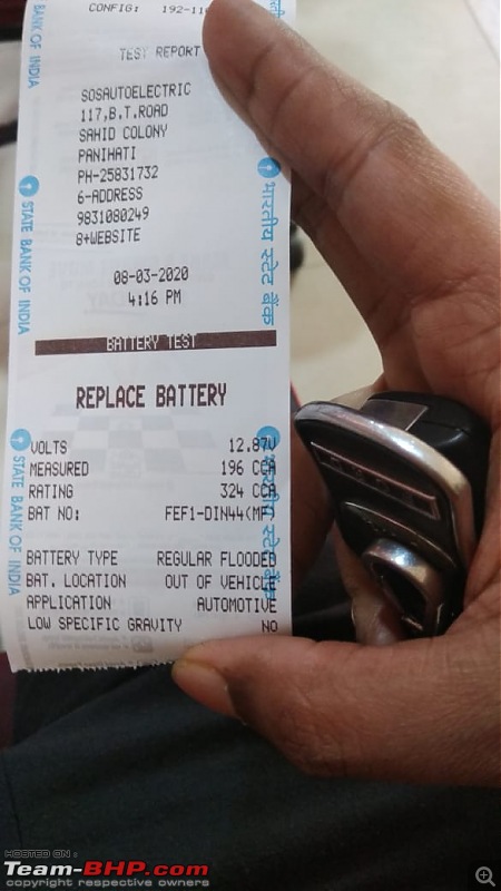

My ecosport's oem motocraft battery lasted 3.5 years/ 51k kms. One fine morning my car refused to crank. Had to push start it. Checked with a local dealer & battery test was done. Battery voltage was ok but CCA was on the lower side. Sulphation was found on the battery terminals as well. I could have continued with the same battery after cleaning the terminals with hot water, but decided against it & changed the battery. Bought Exide Mileage battery with 2+2 years warranty.
Car battery life - How long did your battery last?-whatsapp-image-20200308-16.07.15.jpeg
Car battery life - How long did your battery last?-whatsapp-image-20200308-16.14.52.jpeg
