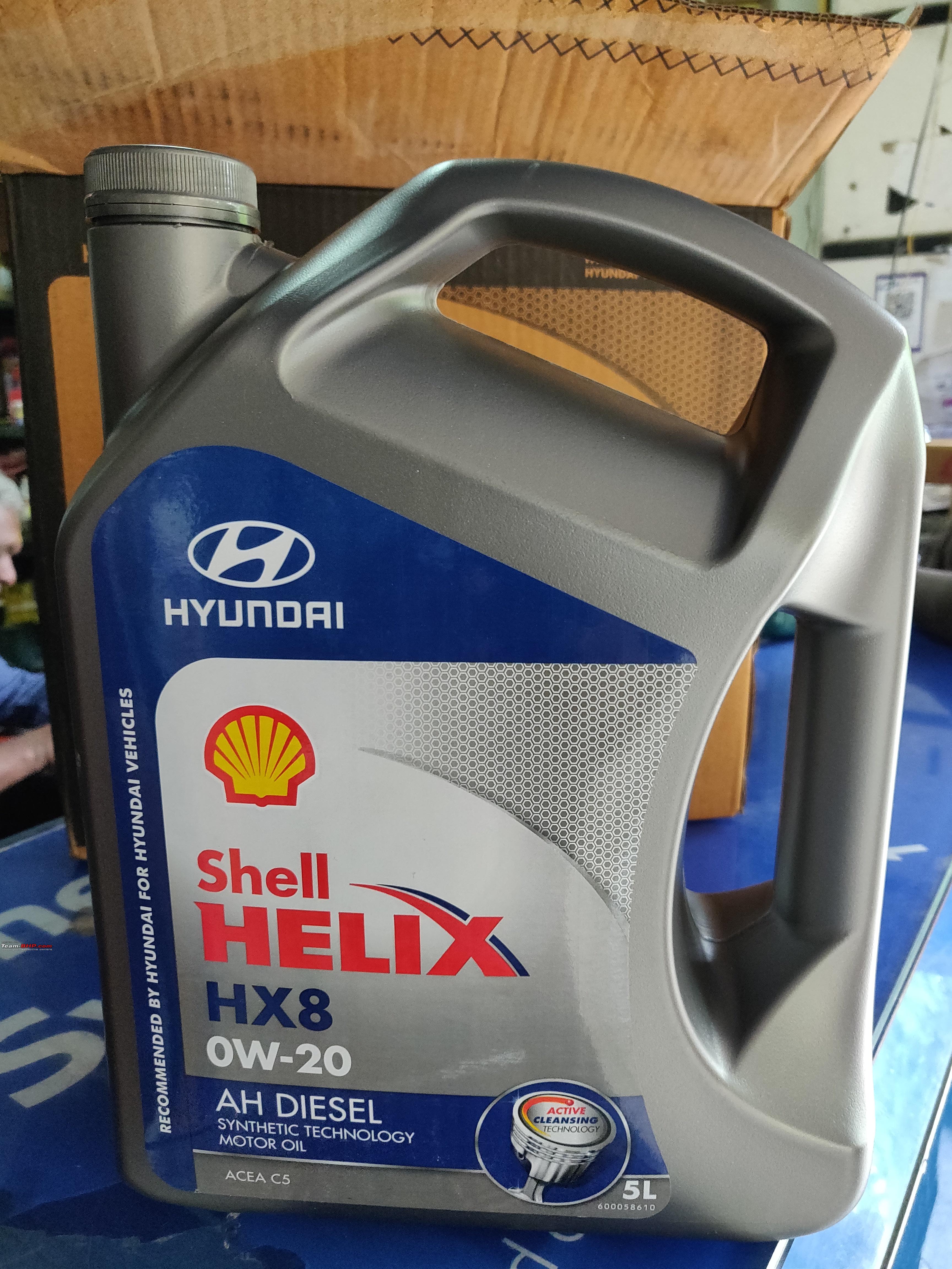

After a lot of circus, I'm atlast able to lay my hands on the hard to find 0w20 C5 diesel engine oil, yes the one for BS6 diesel engines of KIA & Hyundai cars, it's a Hyundai Shell Co-branded oil, semi-synthetic, 5L can costing 2025 per can, that's Rs.405 per litre.
My usual oil & car Spares shop in Bangalore was able to source 6 cans of 5L each, he was able to source through the main distributor for shell oils.
Brought one case (3 cans of 5L each), have kept aside one for T-bhpian Stribog who's picking it up this weekend
PM me if anyone needs it, shop has 3 cans left in stock, I'm based out of Malleswaram, Bangalore
Attaching the images of the same.

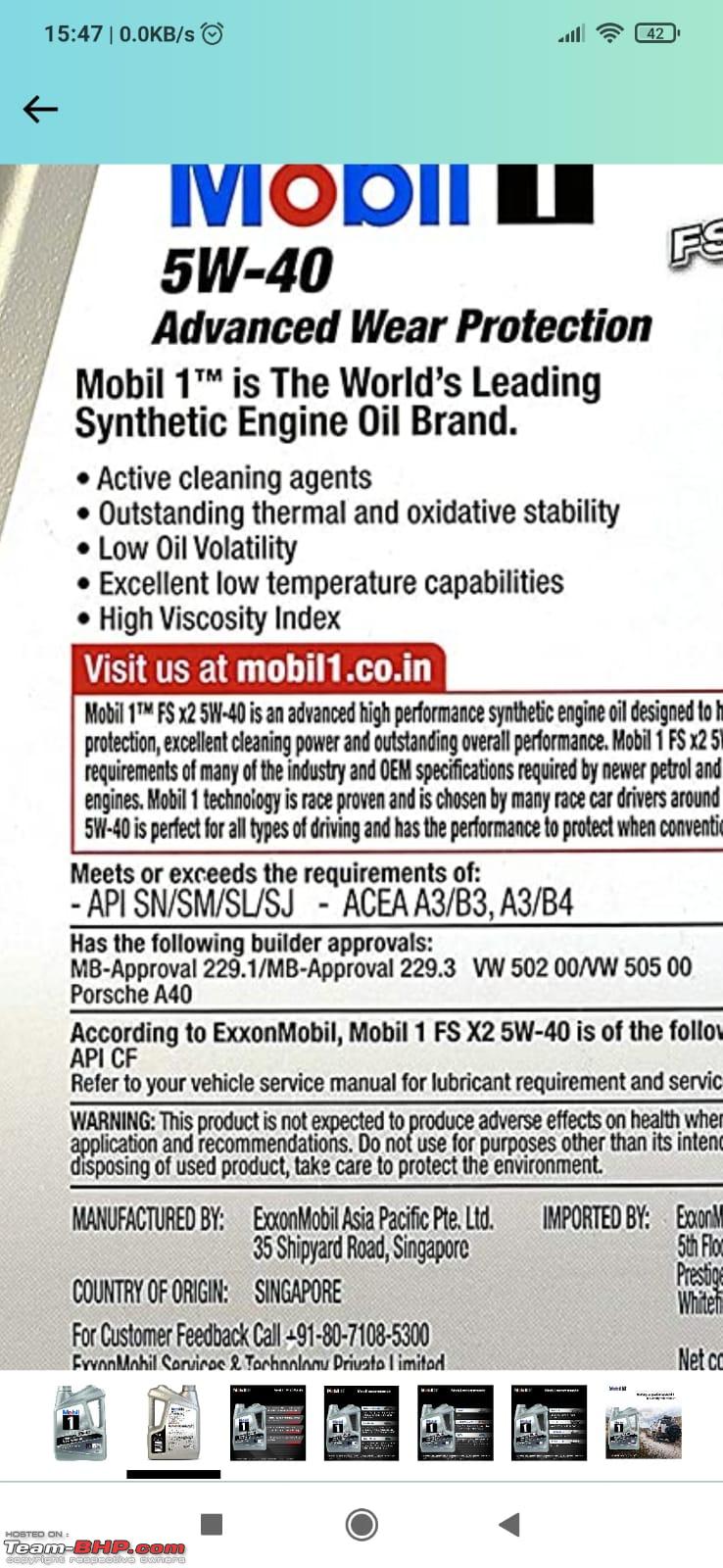

I have used Motul X-cess 8100 Fully Synthetic oil for my Linea, twice for the past 2.5 years. The oil change is overdue by 6 months this year (delayed because I haven't used the car much at all except for long drives of 3-400 kms totalling barely ~4000kms, all due to WFH).
Immediately ~2000kms after the oil change, I'd gotten the timing chain & water pump changed 20k kms before schedule on a friend's advice. Since the mechanic said the oil was ok to be used, they used the same oil.
The seller seems to have an 15% offer today, so wondered if I should change the oil with a different brand (Mobil 1 FS X2 5W-40 API SN Advanced Full Synthetic Engine Oil (3.5L) ) this time :
Can anyone suggest how it fares, as compares is is apparently regularly a usual Dzire segment car.
Older type of oil but a very well formulated one. It won’t hurt your linea.
hserus is offline   (1) Thanks
Attachment 2240675
Price aside, Motul X-cess 8100 seems to have similar but slightly stronger OEM approvals than FS X2.
Specification wise, my vote goes to Motul.
