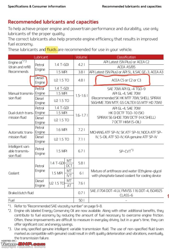

What oil does your Seltos specify and what oil was filled? Is it a bs6 seltos with dpf? Please don’t just say mineral, figure out from the dealer and compare it with what is specified in your car manual.
I always follow your posts on this thread. It's been extremely useful. Let me take this opportunity to thank you as well. Much appreciated.
Yes, Seltos from day one of launch is on BS6. please find the oil spec mentioned in the manual. Guess one can use the same Shell Helix HX8 AH Diesel OW-20 ACEA C5 for diesel Seltos too which Srikanth has mentioned in below post.

Originally Posted by Bibendum90949 View Post
I get my car serviced at Advaith Kia, Lalbagh Road. They did not have the synthetic oil stock earlier. I'll check with them again or even push to get this since if Advaith Hyundai can source it, Advaith Kia can have it too.
I suppose this 0w20 is signfiicantly more expensive than the previous oils, so the dealers are happily filling the cheap oil for bs4 cars to avoid customer complaints. If there is a dpf issue some years down the line then they have a nice repair bill to hand the customer too.
Most customers won't even notice because they are not going to run their cars 10k km a year and they are probably going to sell the car and replace it in 3 years, well before any issue presents itself from using the older spec of oil
