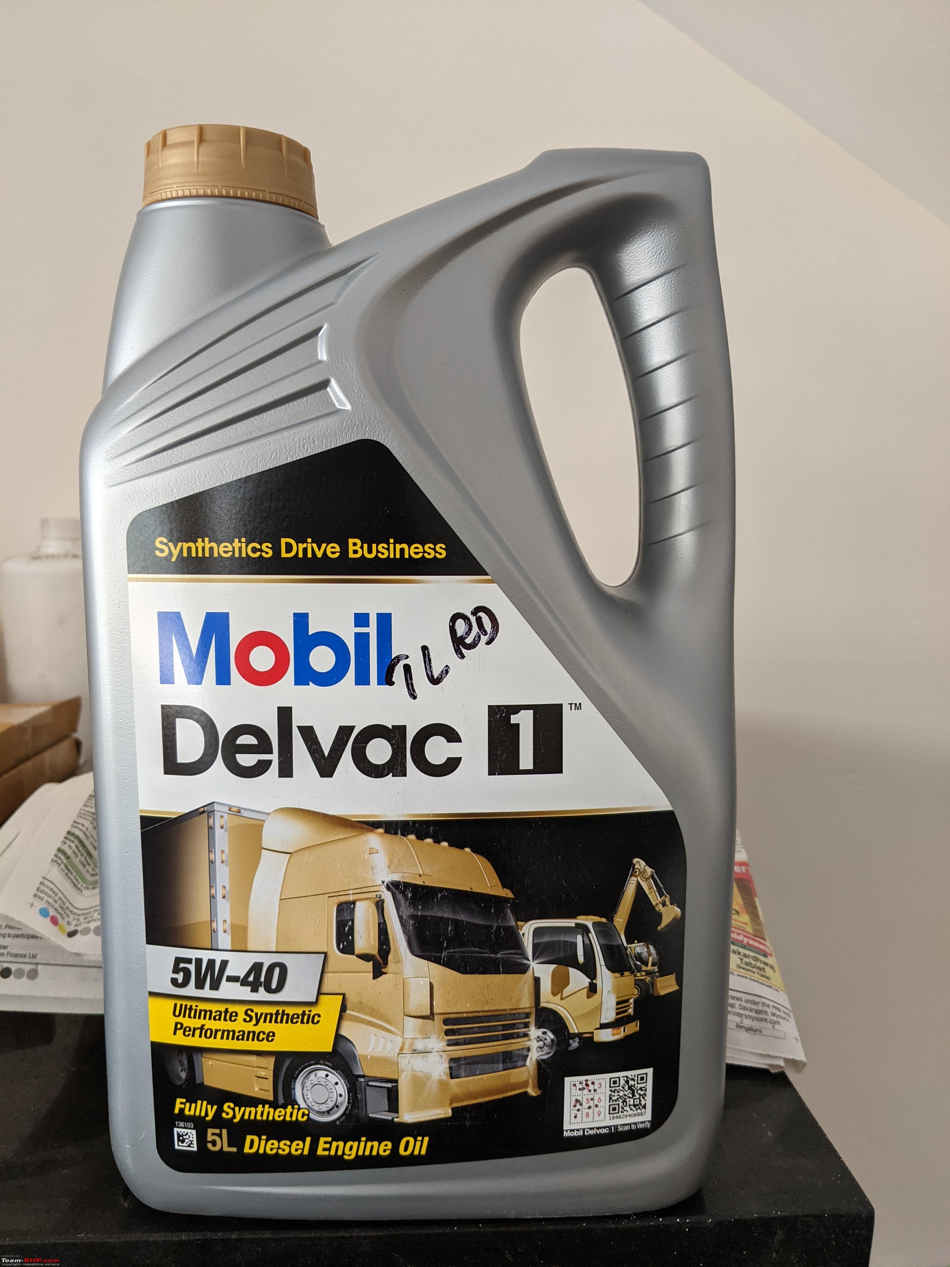

Originally Posted by prabhu.reddy92 View Post
From my next service I want to go for Mobil Delvac 1 ESP 5W-40 and I am unable to procure it in Bengaluru.
Any leads will be very helpful and thanks in advance
I just brought a 5 litre can of Delvac 1. FYI, I have been using this oil in my first gen i20 diesel for the past 7 or 8 years, you won't regret.
Google for West Coast Motors, Sheshadripuram, u will get the number, call them and go. He is a authorised dealer.
West Coast Motors,
No. 126,, 2nd Main Rd, Seshadripuram, Bengaluru, Karnataka
