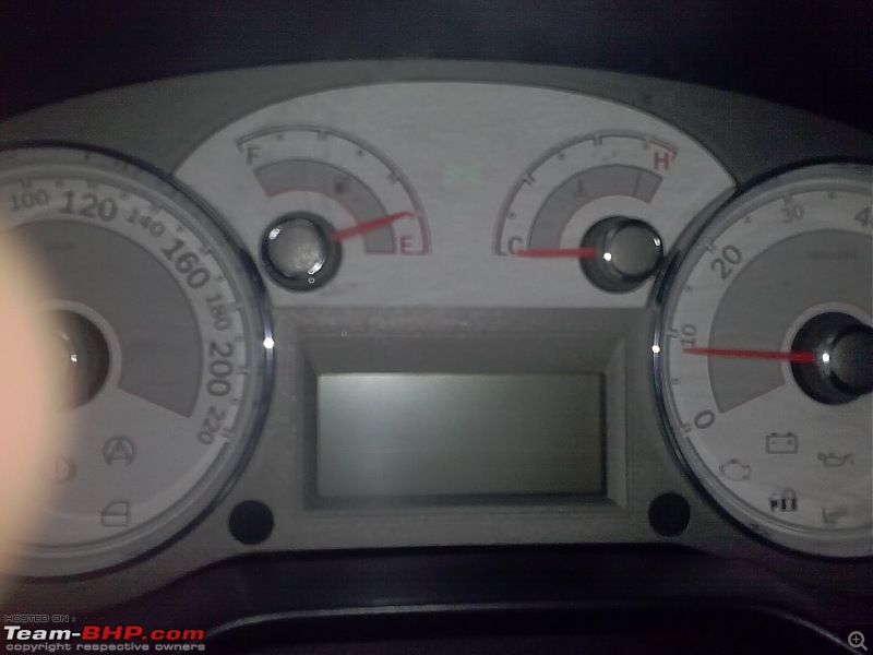

My Feb 2009 MJD emotion pack Linea diesel, done 90k kms had a water leak problem and due to the settled water car had major fungus everywhere including some electrical system like stereo system and the lcd display behind the steering.
My query ........is there a way i can get this repaired and will it start working? Or i need to replace it? Replacing will cost me 14-15k at the dealer end who will replace the entire speedometer unit. There are few local guys who are ready to do it at 6-8k only by changing the lcd display and not the entire speedo.
My music system was not working and i gave it to a local music system repairing guy and he only did 'carbon cleaning' and it has started working perfectly. Is there a way to clean some moisture or fungus regarding this lcd problem and will it again start working by doing so?
Pics attached, the lcd has stopped working, rest other things are working all fine.
Hello Prash,
From what I read about this issue in a different forum, the only possible solution seems to be replacement of the MID, however if you can check with the guys who have helped you with the ICE issue, the solution would be very helpful to many.
Sharing the link related to this issue from another forum.
https://www.teamfiat.com/threads/lin...-issues.13539/
Cheers,
Pradeep.
