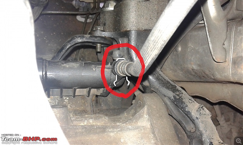

Last saturday I was driving back home at around 8pm and there was hardly a few meters to my house when my clutch pedal suddenly sank and I couldn't shift into gear.
After reading about the various clutch slave cylinder failures in Fiats on TBHP, I presumed it to be a bust CSC even before getting down and taking a look
under the hood (Heck, I even calculated the expense for new CSC incl. Labour and GST) . Anyway with the help of the gradient of the road, I managed to roll the car inside our compound. I opened the hood and found hydraulic fluid sprayed all over the right portion of the engine bay. I pushed the boot of the CSC and found that it was alright except that the bleeder nipple cap was open and the retaining clip had come off. Got a mechanic the next day and got the line bled and clip placed back.
I'm still not happy with it as the clip can pop out if someone touches it from below with slightest pressure. The mechanic says, it is enough to hold the hose in place. Can anyone check if it comes that easily in your cars as I think the clip is has lost its elasticity or was fiat not thinking about the shakes in a car. Please suggest any method to keep it more secured in place. I'd prefer a nut for the bleeder any-day.
Attaching a pic for reference.

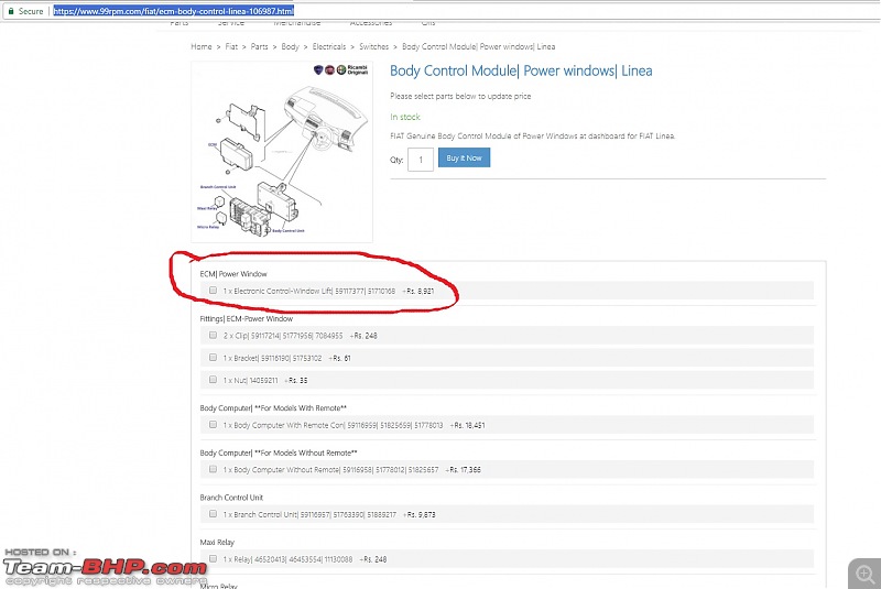

1) AC would stop working intermittently. The blower works fine, but the AC does not seem to blow cold air, even though the compressor seems to be turning on and off. I noticed this especially on really hot days with the car out in the sun. The mechanic at the FNG found a connection in the dash (co-passenger area) where a contact point seemed to be loose. Seems to be working fine as of now. Is there something I should get checked?
2) Power window problem. First the rear 2 power windows stopped working. Although I think it is a relay/ECU problem, the mechanic said it was a motor problem. Replaced both power windows, but the problem seems to have come back, albeit not all the time.
In fact, some of the other power windows also don't work now and then. I read in some forums that it is a relay/ECU problem. I guess I will need to order the parts from 99rpm.com and get it fitted (no service centre where I live). Can someone guide me of the exact part from the picture/link below.
Or do you think the problem is elsewhere?
Link
