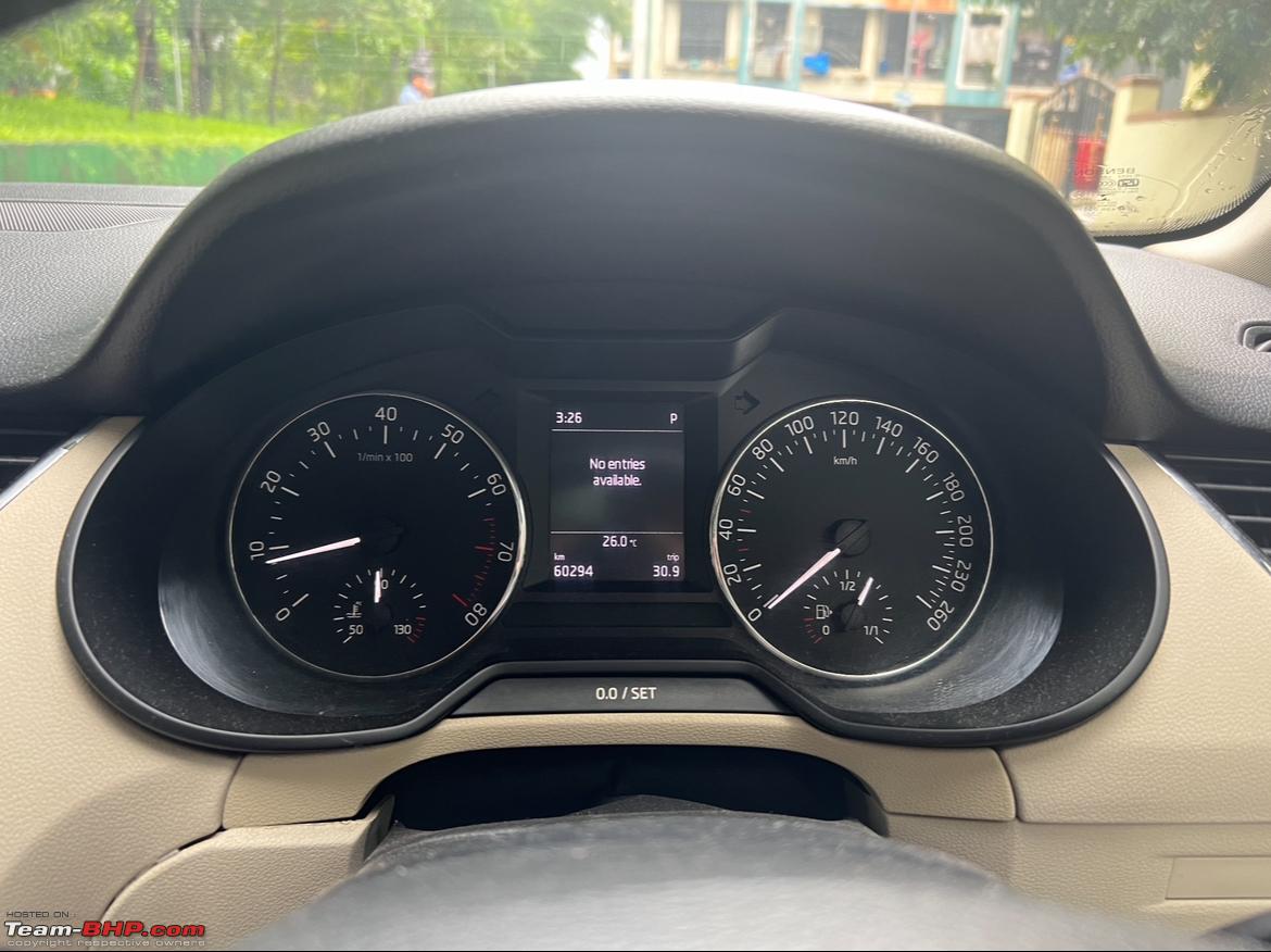

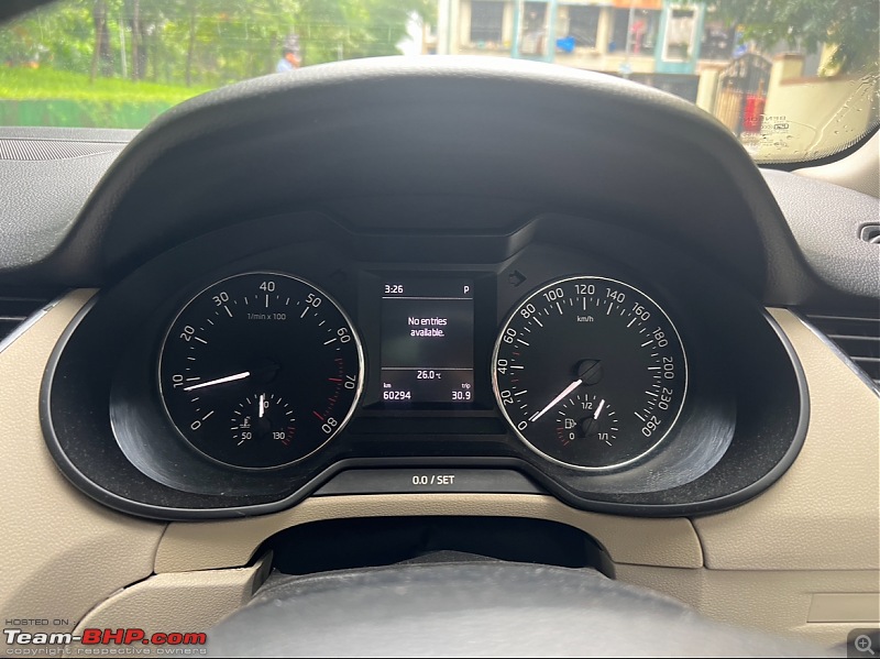

Christmas came early. Off late I’ve been having this issue where every warning possible comes on when the car is started after not being used for more than 12 hours. One by one every light goes away within 5-6kms. I’ve visited my mechanic twice but the problems, quite frustratingly I may add, refuse to reappear in front of him. The car fires up with zero drama so I’m not sure if it is a battery issue. Anyone who has faced a similar situation?
Not pictured here but an airbag light also comes on and the speedo along with the power steering cuts in and out.

Could be an ABS sensor gone kaput, did you run an OBD scan for errors?

ABS Sensor gone kaput in all probability. Check battery as well.

I've had the same issue, it's a dying battery for sure
I had given my car to the local 3M centre for cleaning and they gave me the car back with a drained battery. Multiple jump starts later (battery refused to recharge on driving) I ran into the same issue as you - Christmas lights and the "Error: brake. Workshop!" Warning at which point the car refused to start.
Called a local battery mechanic who pronounced the battery dead
Replaced the battery and all the issues were gone!

Thank you to everyone for the replies. ABS sensors were alright, I had them checked prior to making the post. I had not been driving the car enough over the past month (50-60 kms only) because of the disappearing nature of roads in Maharashtra during monsoons. Have been driving the car more now and thankfully the issue has not reappeared. Checked the battery SOC the morning after a long drive and it showed 100 percent.
