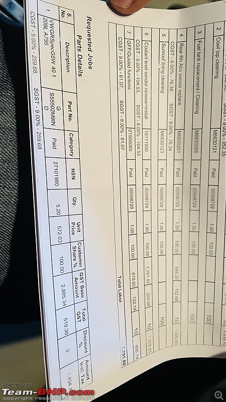

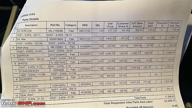

Just out of curiosity, what was the total damage to your pocket for the entire job ?
If possible, do share it item-wise.

Old 29th December 2023, 10:57   #5524
Desmosedici's Avatar
Location: White Village
Posts: 1,501
Thanked: 628 Times
Re: Review: Skoda Octavia (3rd-gen)
Originally Posted by Dr.Vikas View Post
Thanks Raj for sharing.
This seems to be a lucky escape for you, I guess.
25k damage to wallet. Skoda labour rates are sky high.
Plus this time they tried using the usual suspects - sunroof cleaning, fuel tank cleaning and cowl cleaning. Cowl was not even cleaned. Got these out of the bill.
Then they broke the ac vent clip while cleaning. Had to wait for that to get fixed.
This time, the seats were soiled badly. Had to ask them to clean it. The guy who came to clean the seats had a ScotchBrite type pad and a microfibre. Had to remind him not to use the scotchbrite thingy on the seats.
I am very much tempted to get my maintenance done by FNG and get major work, if any done at Skoda.
Attaching the bills for reference Dr. Vikas.
Review: Skoda Octavia (3rd-gen)-img_6897.jpeg
Review: Skoda Octavia (3rd-gen)-img_6896.jpeg
Review: Skoda Octavia (3rd-gen)-img_6895.jpeg
