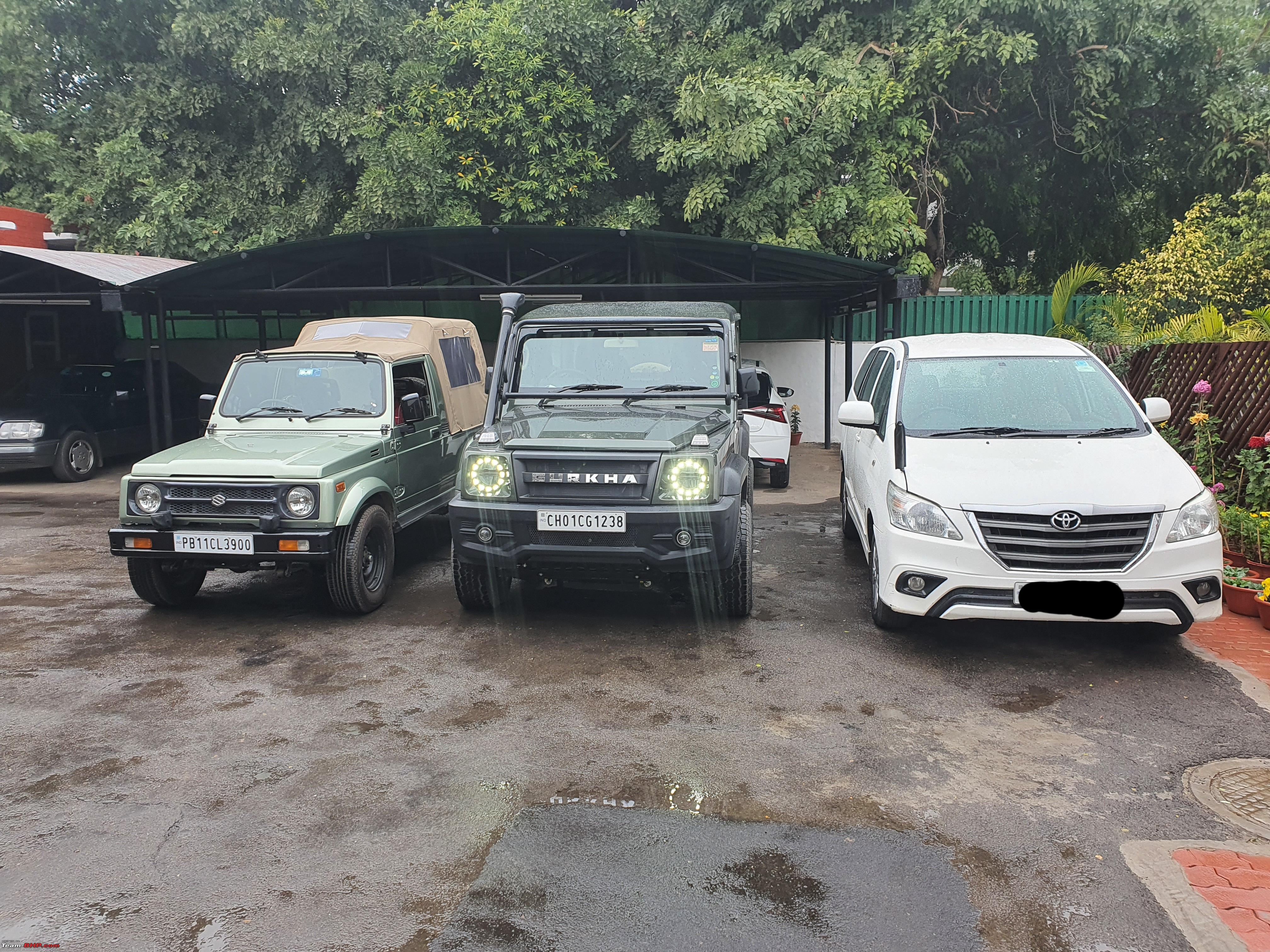

Dear Manuuj, me and my father have religiously followed every update on this thread. I must confess that having followed the thread, it was not long before we too test drove the vehicle and took delivery of the Gurkha on 11.12.2021. It was certainly an impulsive decision and one taken from heart and not the mind, as there wasn't any need of buying another vehicle. Having said that, it's been a pleasantly positive ownership experience. Here's a few pictures of our car:
We have retained the stock tyres size i.e. 245/70/R16 but changed the tyres to Apollo Apterra AT-2.
Here are the list of Modifications:
IPH Bi-xenon 3 inch Fog Lamps coupled with 4300K GS Bulbs. They were sourced from Amit, Blaze India.
Blaupunkt Horn
Plati alloy wheels painted in matte black colour
Armoro spare wheel cover.
Here's a few pictures of the car height/size comparison to a few other vehicles:

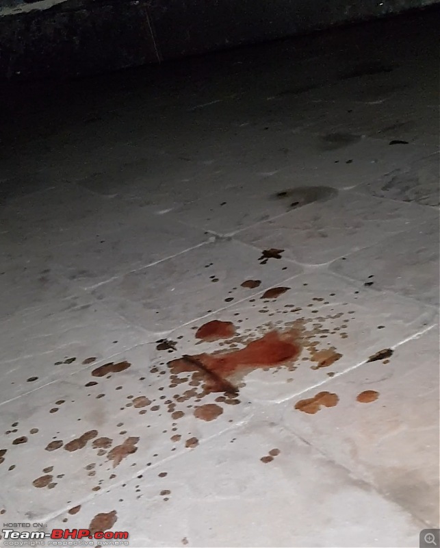

My experience from last evening ran like this.
I was about 700 meters from my house when i heard a strange whine coming from the bonnet.
(I know now that it was the Power Steering Motor that was making the noise as the Power Steering Fluid had started running low due to a leak that had developed.)
The steering started feeling very heavy and also the noise increased. By this time I had reached home and I quickly parked up inside.
I looked under the car and realised that a Red Fluid was rapidly dripping out from under Asterix. This i reasoned must be the power steering fluid leaking that caused the subsequent loss of Power Steering.
I called up Ved Ji and he asked me to check the Power Steering Fluid Reservoir. I did so immediately and found it to be almost empty!
He asked me not to drive the car and assured me that he will be with me in the morning with a mechanic from the workshop and Power steering fluid as well.
He arrived in the morning today and the mechanic quickly tightened the nut to the T-Joint that had come loose.
Ved ji told me that it was in contact with the radiator hose and the vibrations of the engine had made the nut come loose over time. This was a design issue with only some earlier Gurkhas and the issue has been resolved in all the later models by relocating the Pipe carrying the Power Steering fluid to the brass T joint further away from the Radiator Hose.
They made the necessary adjustments to the pipes, tightened the Nuts and refilled the Power Steering fluid and bled the system also to make sure there are no air bubbles trapped in the system. We drove to the workshop then so they could take a proper look at everything and also check the Gear Oil Seal fix that had been done sometime back. Post this we took a test drive and everything was working fine again.
Ved ji and Nitesh ji assured me that this issue has been diagnosed and fixed for good now. He further told me that they will check all earlier Gurkhas for similar issues and fix them if found. The entire process of relocating the pipes, tightening nuts, refilling fluid and bleeding the system took barely 30-45 minutes and was pretty simple and straightforward.
As a Gurkha owner I wish this Power steering pipe and the Gear Box Oil Seal leak issue had been diagnosed and fixed during their own vehicle testing process and I as a customer did not have to deal with it. At the same time the response and support from Force Motors After Sales was lightning quick. The issue was diagnosed and fixed very fast. I checked a new Gurkha that was also standing there as well as their own Test drive vehicle and found that the fix of relocating the pipe had already been applied to both of them from the factory itself.
There is some communication gap between the R&D and Production departments at Force Motors and the Aftersales Department is facing the brunt due to this. This needs to be addressed.
Force Motors can ill afford bad publicity by any disgruntled customer left stranded on the side of the road due to these minor design issues that cause these problems. I too was very fortunate that i was only 700 meters from my home when this happened and not on some faraway snowy trail in Spiti or Ladakh.
These pics below may explain things better:
Leaked Power Steering Fluid on the driveway. Asterix is bleeding!!
Asterix, my 2021 Force Gurkha | The adventure begins-screenshot_20220105150524_video-player.jpg
One can see the fluid leaking everywhere.
