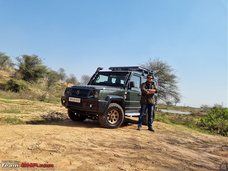

Asterix will soon feature on a YouTube review of the '21 Force Gurkha by "91Wheels". We did the shoot today and it was quite an experience. The amount of camera equipment they invest in is commendable. I am sure the video will be have a very professional feel to it.
Here are a few pics as a sneak preview
